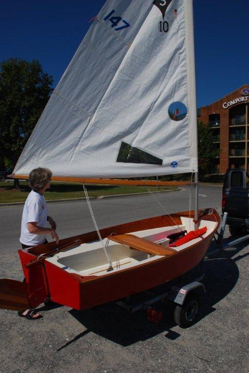

Peter HK Posted January 20, 2010 Posted January 20, 2010 I agree with Tom that a groove in the edge of the rudder head is desirable so the downhaul line won't slip between between rudder and box. I routed mine. Regarding the uphaul, I'll include a photo of mine...it's the yellow line. It cleats to a simple horn cleat. Quote

Peter HK Posted January 20, 2010 Posted January 20, 2010 One of the things I'm trying to understand is the holes in the rudder blade. Hope this helps Quote
sscoville Posted January 20, 2010 Author Posted January 20, 2010 That's great. It's the way I thought it was. Thank you for the pictures. Quote
