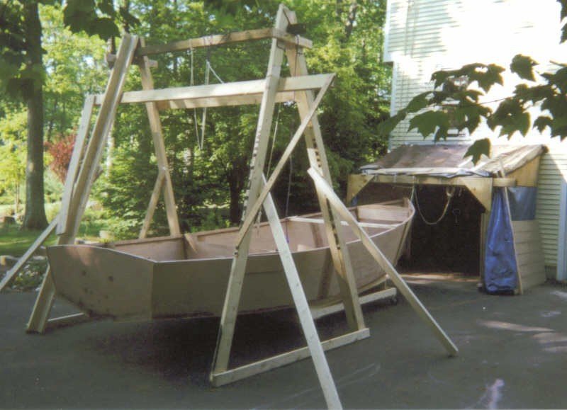

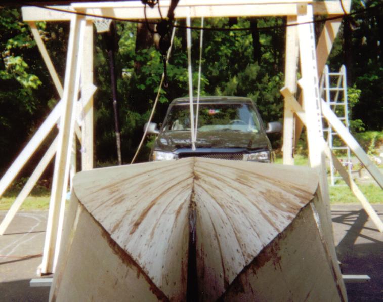

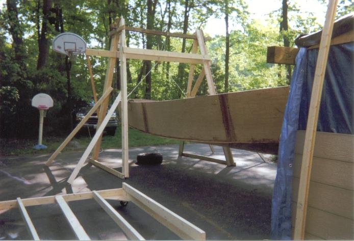

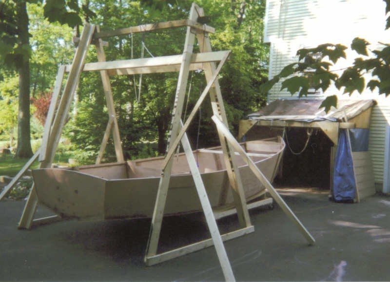

Guest LeeH Posted June 1, 2009 Posted June 1, 2009 I copped these pics off somebody's build blog at some point in the recent past. I guess it's okay to post them here. Quote
Greg Luckett Posted June 1, 2009 Author Posted June 1, 2009 What about borrowing a couple of engine hoists - depending on the size of the boat you could put one at the bow, one at the stern, lift and turn. On my Weekender I installed a solidly mounted eyebolt at the stern for just such purposes. Another good idea, thank you. Something like that might work for me except the boat needs to be raised higher than that to clear the trailer or frame it is sitting on. My Spindrift 12 is not hard to roll over with jus the two boys and myself, but if I do a bigger boat, such as a Core Sound or the Princess Sharpie 26, it will definitely be needed. Maybe a lower build cart or raise the cranes onto a stage? Quote
Greg Luckett Posted June 1, 2009 Author Posted June 1, 2009 I copped these pics off somebody's build blog at some point in the recent past. I guess it's okay to post them here. Yeah! This is one of the ones I remembered seeing before. Thanks! Quote

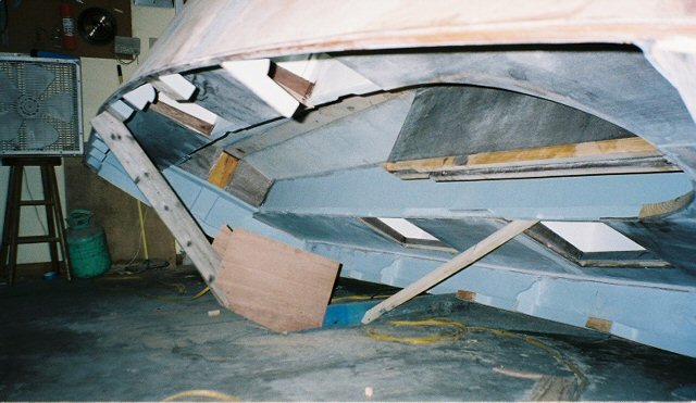

PAR Posted June 2, 2009 Posted June 2, 2009 On my last build I found the need to roll the boat several times and also to help work in the down hand position for finishing and 'glass work. I made a cradle under the boat, that allowed it to flop over on each rail, which placed the bulk of the bottom about level. This made the finish work easier. The first image is the roll over which was done with a block and tackle. The second has her flopped over on one rail, viewed from below. Quote
