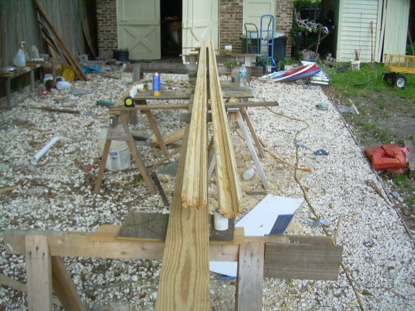

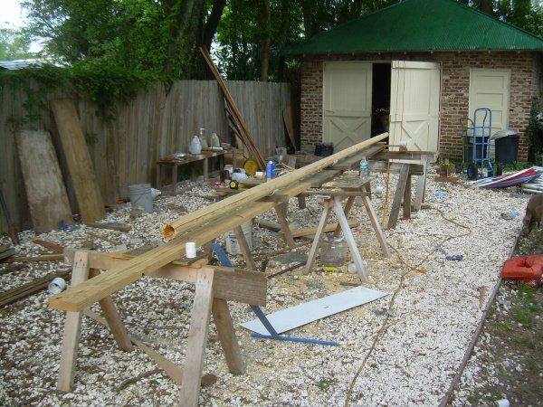

An idea I borrowed from Charlie Jones is to build the birdsmouth mast in halves to fit blocking in the places where you want extra beef for fastening hardware.  Use packing tape in the appropriate "vee" when gluing up the mast so the epoxy won't stick.  Then you can take it apart, epoxy in the blocking, and glue the two halves back together without the tape.  This is the mainmast for a CS17 going together now.
