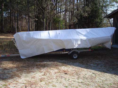

No small boat, wood or plastic, should be left out in the elements, whether it has a drain or not.  Best to be inside, but under a tarp is a reasonable choice.

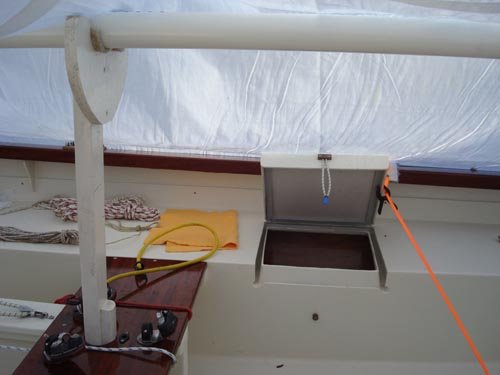

It should have a drain and that should be at the low point and open for storage.  For long term storage, inside lockers and inspection ports should be open or gapped for ventilation.

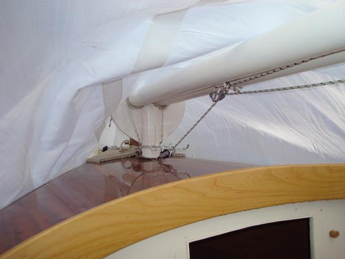

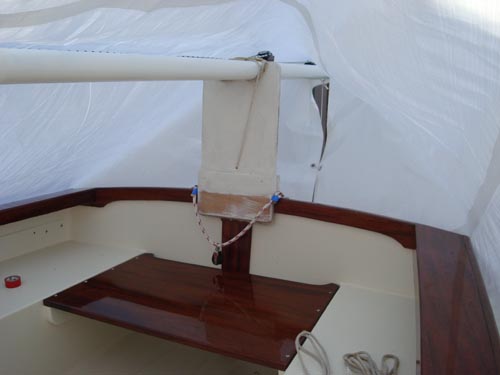

In the photos below, Lapwing has been fixed with mast supports for trailering and also provide an excellent ridgepole for a tarp.  My boathouse is already full of boats so somebody has to be stored outside.  Cheapo tarps are, at best, good for one season.  The tarp shown can be had from: http://www.tarps.com/white.htm
As a last resort, turn the boat upside down and block up off the ground.
You quite correct Tom, but some folks for one reason or another just can't do this, so a least provide a way for the water to drain off.
