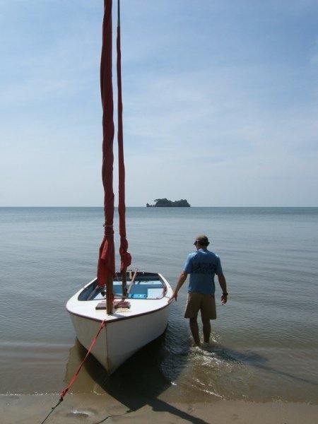

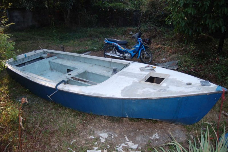

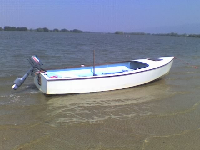

  2. Hi All Yes, an Andersen Bailer would be the thing to have. But of course I couldn't find one around here the time I built the boat. But at least a drain plug would be good. Anyway, don't trust those cheapy tarps for sure. Well, here it is. Some fresh paint and it looks ok. Didn't find any serious damage. I touched up the interior with some blue that didn't quite match, but whatever.. It's an "expedition boat", not a show piece of fine craftsmanship. Should get it in the water tomorrow if I can get bribe the neighbors with enough rotgut rice whiskey to carry it over the the canal about a hundred meters. I don't know what I am going to do with this boat once I go back to Japan. The locals aren't too interested in sailboats, so not easy to sell. Maybe just keep it at my friend's seafood factory on the coast and hopefully be able to come back here for sailing holidays.. PeterP, yes, Thailand has changed a lot since the 80s. Still a good place, but I have been feeling frustrated with the place lately. The politics here are a mess as you have probably heard. It seems as if its slipping back into the real "Banana Republic" mode again.. That airport fiasco was just outrageous. Only in Thailand.. :

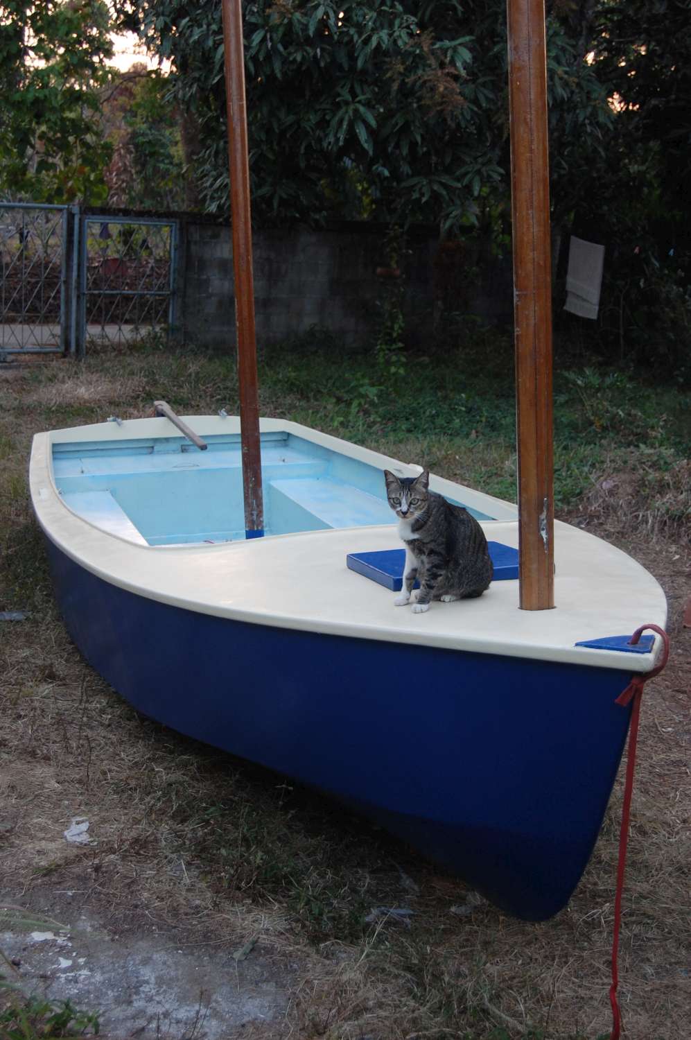

  3. Well, I went to Laos for six months for work, then last week came back to Thailand where I had left my boat in the garden under a cover. However, I have discovered the cover developed a tear and the boat sat in the rainy season, mostly full of water for several months.. hmm.. Well, the paint is a mess so now doing some quick fixit work so I can get in a few weeks of sailing before I move back to Japan at the end of the month. My boat always gets trashed here by the canals, the oceans, my friends and the overall experiences I have. Such as getting rammed by fishermen, getting stuck in mud flats, bashing into things, etc. Plus 4 meter waves last May. That was "super sporty", so much I don't even want to talk about it.. haha.. I guess it did pay to have the boat blessed by my local Buddhist monk. The boat and I are still here. Anyway, since its usually covered with blood, mud and sand or full of water I have learned to just keep it simple. No more bright work, simple enamel paint, just a utilitarian sail boat. Homemade sails, cheap rigging, wooden masts, it works great actually. So epoxy and paint after removing a lot of blistered paint. Plus fixing broken bits such as the hole in the side that a piece of rebar made when I was going through a canal gate that was a bit narrow. And the centerboard was warped slightly. I reshaped that using an angle grinder with a sand disk. Highly recommend that for removing material very quickly. I did dig into the wood and it seems fine. That apitong ply is very durable. Heavy and stiff, but damn strong. The boat doesn't even have much of a name. I call it the Sea Cow. It used to be white, and "sii khao" in Thai means "white color". I know, bad play on words.. It's blue now, but still the Sea Cow. I'm not even going to bother repainting the interior since I can't keep it nice anyway.. Just clean it up and go for the islands near Cambodia. Sailing, fishing and camping.

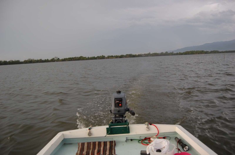

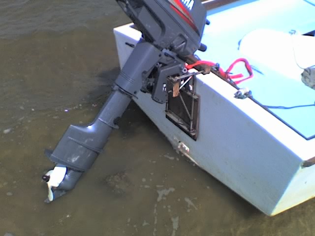

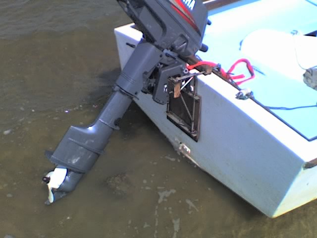

  4. Greg: sometimes I swap the motor out when I am going to do some motoring for considerable distance, sometimes I don't. I was low on fuel that day so I wanted the best efficiency possible. The rudder is a bit difficult to stow, but its only temporary. When it's time to sail, I move the engine over to the side. When I made the boat I made the dumb error of making the transom too wide for the engine mount. So I welded up a crude mount from stainless steel that clamps on to the transom and which has a piece of teak that the engine clamps on too. Works okay. Howard: Yes, they drift with those poles using lines as far as I know. Also they do a lot of netting around here. Actually, a lot of the fisherman around here are squid fisherman. The boats do have fairly how bows, but overall the Gulf of Thailand in this region is pretty tame water. Rarely have any big storms or sizable waves. The ocean is a more intense down south and on the other side of the country.

  6. Thanks for the replies, guys. ;D It was my fault. I knew about the mussels, but my previous experience with them was on the far side of the inlet. I was tired, grumpy and in a hurry so I didn't even put on my flip flops. Oh well.. feet are fine now. I don't see a fuel filter on this Yamaha 3 two-stroke, unless it's inside the tank. I do always use a funnel with a filter in the neck. However, this was from gummy junk in the bowl which was from gas left from a few months ago. My fault totally. Besides that, its a great engine, and plenty of power for a CS17. I'm going out tonight to the inlet to go fishing. I plan to just drop anchor and fish all night. Not even sure I will put up the masts. I will sleep in the boat and come back in the morning. What I will catch I am not sure. Will see how it goes.

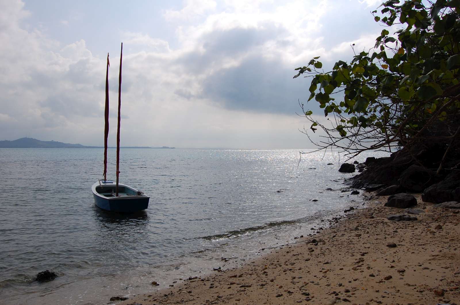

  7. Hi all, Thought I would try to get my CS17 back into the water after sitting in my yard for several months. First a new paint job, as white was a bad choice, at least for the hull. After a season of bashing around the canal from house to the ocean, it looked pretty bad. So a dark blue this time. Used the local 3 dollar a quart enamel which actually holds up quite well. Can't be fussy, its all I can find around here. I spent seemingly days fixing dings, cracks and problems from last season. Sand, epoxy, fair, paint, blah blah.. you know the drill. So we move it over to the canal and immediately beat it up by cracking the coaming and scraping the hull. No matter what I do, I can't keep this boat pristine for very long. Decided on a sail to Koh Chang, Thailand's second largest island after Phuket. About 50 nautical miles from my house. David and I left about daybreak, making our way down the canal, into the bay and to the ocean. That takes more than an hour. Once we are out there, there isn't much wind, so we putt along at 8ks per hour with the Yamaha toward Chang. We stop for an mid-morning nap and coffee on a small island, where it then rains heavily on us. After an hour, clear skies and a decent wind about 15 -20 knots or so. Off we go toward Chang at about 4-4.5 knots, into the waves on a close reach. Lots of spray. David gets soaked. And he also manages to get nicely sunburned. I told him to cover up that white English skin of his, but he failed to listen. : Being indoors in an office in Bangkok for two years didn't help. About 6 pm we make the tip of Chang and find a small beach to camp on. By this time David is a bit miserable. Sunburned, wet, and tired. I'm zonked too, especially since I had no sleep the night before. But we make camp and build a fire. I whip out the pressure cooker with potatos, carrots and chicken and get that going. David pulls out a bottle of Spanish red. Things are better. David wants to sleep on shore, I elect to sleep in the boat. I recommend he sleep in the boat, but he thinks its better on shore. Ha ha, he is up all night from mosquitoes, his sunburn, and the tide washing into his tent. I get a few nice hours in the boat, enjoying the gentle rock of the boat. Burning a mosquito coil helped. The next morning David is not feeling that great. Our plan was to sail for two more days to the east end of the island where there are numerous other islands with snorkeling reefs, nice beaches and night-time parties with the tourista girls. No, we had better go back and get David home, as his sunburn is pretty damn bad. Nice blisters at this time. Plus his back, with two bad discs isn't feeling great. So we head back to Chanthaburi at about eleven, after procrastinating a bit. We think we may stay half way somewhere, maybe a bungalow on one of the beaches somewhere. However we have a great sail, hitting six knots at times and much drier and the waves are in our favor. I calculate we can get home the same day, with only an hour or so in the bay during the dark. So I set a 320 degree bearing straight for Laem Singh, where the bay starts. David conks out in the boat for several hours, he is so tired. Everything goes well until about 16:30. Winds then start to get very soft and we are in a race against the dark. So I fire up the engine. It runs, then it quits. And it won't start again. We are about six miles off shore. Lame. It will be dark soon. David takes the tiller with what wind we have, about a knots worth, and I yank the outboard into the boat. I never go out without some tools with me. So I take the carb completely apart. Alas, my screwdriver won't fit in the recess for the main jet. Ahh, my Leatherman. Just fits, and sure enough, find clogged jets. This is entirely my fault, as I forgot to drain the gas last season, so there is junk in the bowl. Such fun doing this in a rocking boat when you are tired and just want to get home. BUt it fires up and off we go. Ahh wait! We have to take down the masts as we need to go under two small bridges near my house. This is always fun as they are one piece wooden masts I can barrel handle myself. I nearly fall in, but I don't. We make it into the inlet of the bay, under the bridge and get inland. Then the engine stops again. Same thing, refuses to start. And we are drifting toward a big bamboo fish trap. So I drop anchor. Now it's too dark to work on the engine, plus I am just too damn tired. My mobile phone rings. Another mate inviting us to a party and BBQ at his house. I laugh and say we might not make it. Now if I was alone, I would have just dropped anchor, pulled out my comforter and pillow and figured out the next morning. But I feel I need to get David home. About ten k's of bay and canal to go. I get out the oars and start rowing. What a joke. But the tide is in our favor. I figure it will take about six hours, haha. I try this punishment for 20 minutes then I try the engine. It runs! Off we go. The tide is coming in, but the bay is extremely low. I make an error, as its damn dark now, and I haven't been on the bay in about six months so I was a bit confused. We run aground. I know its mud down there and jump over the push the boat. Push, push, then I cut the #$*%*! out of my foot. We are in greenlip mussel farm area. Ignore the pain! Arggh, my other foot! We keep pushing into deeper water. Where is that damn channel? Right, there it is. Off we go again. My foot, actually both feet are bleeding like crazy all over the boat. Never mind. Finally we make it to my village. We pull up to a restaurant on the water I know and David orders two large Heinekens to go. Sometimes beer can taste so good. Now we head up the canal, about 3 ks of narrow, snaking canal to follow. I drift a bit too close to the bank and the engine stops. What the.. ? Fishnet this time. Wrapped all around the prop. Easier to take the engine off an remove the prop as its a huge mess. 15 minutes there. How my hands hurt. Continue on. Then the same thing again. Except this time some moron put a gill net completely across the canal, a public thoroughfare. This net is big and nasty. Repeat engine and propeller stuff again. I do a nice job of whacking up the net to let the guy know he shouldn't put it across the canal. I spill my beer dealing with the net. Not cool. Is the beginning to be the Trip From Hell? What next? Finally! We make it back to my house. The boat is an absolute mess! Mud, gas, blood, seawater, junk everywhere. For a laugh I take a picture. We can't move, but we need to unload the boat, at least some of it and carry it the 200 meters to my house. What a drag. My foot is killing me. We manage. We are both in pain, but after a shower we manage to go to the party. But we both have to leave after 90 minutes because we are in too much pain. My feet are just burning. I went to the clinic the next day to have them cleaned. Fine now. Here are few pics. One of the boat in nice condition, the beach at Koh Chang, our Google earth plot, heading back trying to beat dark, and David contemplating the whole adventure (mess?) once back home.
  8. I have a 3hp Yamaha two-stroke on a CS 17. Its just about right, I can hit nine to ten kilometer an hour with it. I have to have one, as I live way up a meandering canal that leads into the bay. About ten ks to the ocean. No way to get back into the bay when the tide is going out, it rips out through a bottleneck incredibly fast. Sometimes I just motor around the bay with no masts. Have put ten people in the boat, no problem for that 3 hp.

  12. There are a miles of canals and mangrove regions behind my place, so I also have used my CS 17 as a regular powered run-about to go to some of the restaurants and other places I like. The bridges are very low here, so when I go sailing, I have to go down the canal behind my house about 3 ks with the masts unstepped of course.I tried rowing a few times, but forget that.. I am in okay shape, but I don't have that much time, especially against the tide. I made a mount for my new outboard that works really well. I can locate it anywhere on the transom. When I am simply power boating around, I put it in the center, when sailing, on the side of course. Its stainless steel plus some left over sheet wood. I used an old computer mouse pad as the cushioning. That works great! Here are a couple of pictures, sorry for the low quality, as I took then with my telephone camera.. I hit a maximun of 11 KPH with the 3hp motor at about 1.5 liters per hour of fuel.
