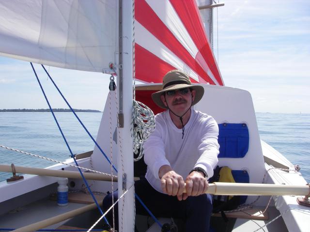

The CS 20 is a delight to sail.  She accelerates quickly and responds well to adjustments in weight and sail trim .  With a dodger and floor boards doubling as a bridge across the footwell, she will make an adequate camper, but you would be happier bringing a tent and staying on the beach,.  She  has all sorts of room for crew and lots of storage (and flotation) in the seat/tanks.  It's fun building the 20, and you can't get that on the Sea Pearl.  The CS 20 is far easier to row.

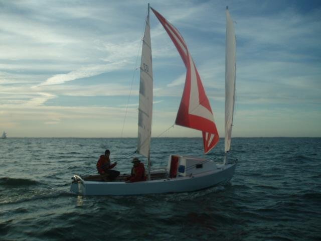

The CS 20 is a dream downwind.  At the Rend Lake Messabout last weekend she was surfing breaking 1' to 1 1/2' waves in a 20-25 wind and giggling about it.  Easy to control, dry, and shares the advantages of the unstayed cat ketch rig.  Even when she is going fast, she is dry.

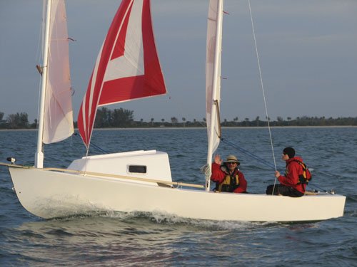

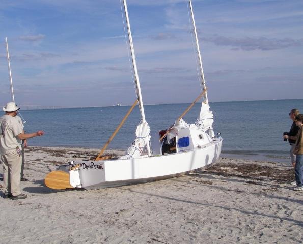

Welsome!  A cabin of your own design is an option on the CS20.  You can see in the photos the cabin we built on CS20 #103 "Dawn Patrol".
In the Everglades Challenge '08 our ride was extremely dry  --which is one of the main advantages of a hard cabin or soft canvas dodger.  You can see 'worst-case' spray deflected in the following video from our EC'08 run:  http://sailnaway.blogspot.com/search?updated-max=2008-03-07T02%3A26%3A00-05%3A00
