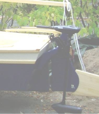

Pepe Posted May 29, 2008 Posted May 29, 2008 Hello I mount my Yamaha ( made by minnkota ) with angled mounting plate. BEcause I wanted to move motor more away to awoid messing with ropes etc. Sorry for the bad images. Quote
Dave R1 Posted May 29, 2008 Posted May 29, 2008 I forget which shaft was on mine but I think it was the longer one. I could have reduced the height of the motor mount by an inch or so but it was never an issue as far as keeping the motor in the water. I initially thought about making a motor mount that moved the motor back a bit but there was already too much weight in the stern end compared to the bow especially with my lard at the helm. I figured it didn't make sense to shift weight any further back. Having the battery in the bow helped a lot but I could have stood to put another battery's worth of weight up there for trim. Even with the rope horse across the back, I never had any problems with things snagging on the motor. I usually kept the handle pointed down as you can see in the center picture. Quote
