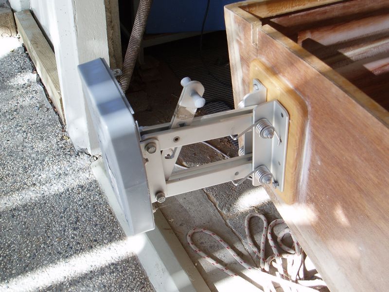

I have a 2hp yamaha 2 stroke which is one of the smallest and lightest motors available here, but the shaft is also quite short. I didn't want to cut the transom that low so went with a purchased adjustable outboard bracket. It certainly will get it low enough and lifts high out of the water and will probably leave the mizzen sheet a clear run. It does put the weight out a little further aft.
Here's a pic
