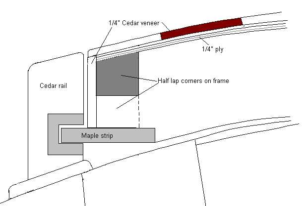

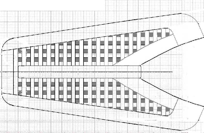

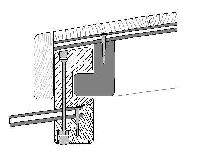

Barry Pyeatt Posted October 18, 2006 Posted October 18, 2006 I did the concept drawings for the bowsprit. A couple of them here. A couple of drawings from Paint that I did of hatch covers. I've had some drafting experience plus I do a lot of watercolors. Lots of them architectural in nature. So perspective is a good thing to have some basic understanding of if you want to draw things out so that they are clearly understood. But they never come out to scale. With Sketchup they are isometric projections so the measurments are accurate if you draw them with the scale. Quote
