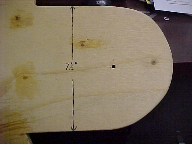

Dennis, recently I drew out the Weekender rudder from the plans and found that those radii are incorrect. Actually they should have been identified as diameters. I don't remember what I did when I laid out the rudder to actually make it but here are corrected dimensions. Note that if the pivot hole is placed as per the plans in the rudder and the rudder box, you'll end up needing to extend that 8 5/8" dimension a little to get the rudder to swing through 90
Just replaced my rudder too. Didn't work for me either. So I laid a Mark I Calibrated Eyeball on it and something round on it, not sure what now, maybe a paper plate, about the right size and laid a curve on it.

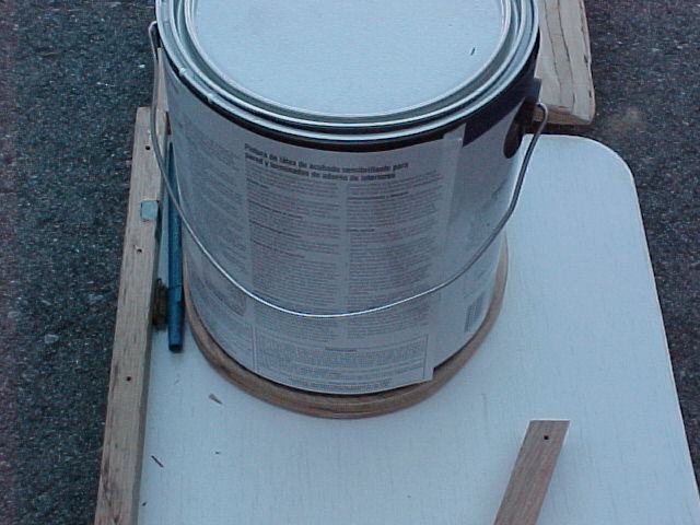

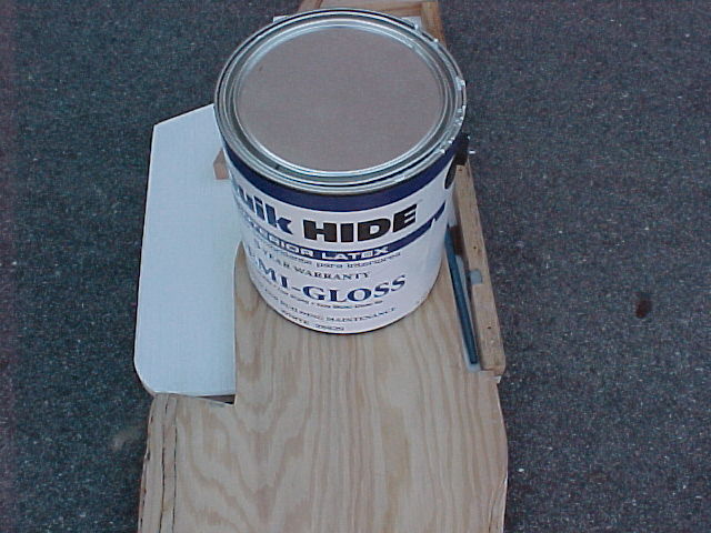

Here are a few pictures I took to give you an idea on how it looks with a gallon of paint for the circle in the picture you will see a pen on the back side of the rudder that space will have a bungee cord that runs throught the top of the rudder box and a cam cleat on top when you want to put your rudder down, as you pull the bungee it pulls the rudder down and holds it in place and if you hit bottom or something it releases it so it wont break your rudder.
