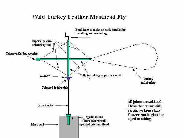

Has anyone seen plans, or can figure out how, to build a masthead fly (wind chicken)? I know they're not expensive, just one more little touch that would be cool to say I made myself. A quick search of the internet didn't turn anything up.
I have one but usually forget to put it on the mast until too late. I put some streamers on the forward shrouds and end up using those. If you want one look for a Windex at West Marine or wherever. Don't bother making one. Your time is worth more and besides, you have a boat that wants to get wet. If you have your heart set on making one, wait until after launching,

Never used one myself- we use streamers on the shrouds, and Laura doesn't even use those- she just feels the wind- unless it VERY very light air..
On the MiniCup I used a rig that Charlie showed me attached at the end of the gaff way out at the bow of the boat and attached old cassette tape as a streamer. With it right in front of me and in front of the boat it was easy to monitor.
Has anyone ever thought of putting a wind indicator at the end of the bowsprit?
If you look closely you can see the one I used on the MiniCup:
Yup, got tell-tales for the sails, myself. But, looking at the boats in the GSL marina, I noticed the masthead flies as well. Not an instrument I plan on sole dependency, just another source of input. And another little project. Thanks to all for the awesome input.
