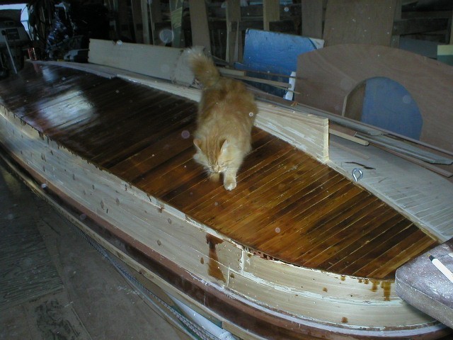

Nice layout and joinery work on those gunwales!!!
