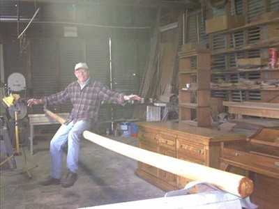

Free standing masts depend on that bend to let pressure out of the top of the sail also. Here's a pic of a 22 foot spar I built for a gaffer in Florida- weighed 42 pounds. 3 1/2 inches aroun d up to the 18 foot mark, thentapered to 2 inches. He's delighted with it.

nope- in fact we experienced exactly the opposite. The spar came out too stiff. Sails will most likely have to be recut because they were cut for a bendy spar. You can control the amount of bend by the thickness of the walls of the spar. You can offset the birdsmouth slightly and get more beef inside or out' date=' depending on how you use them. Also you can use thinner or thicker staves.
