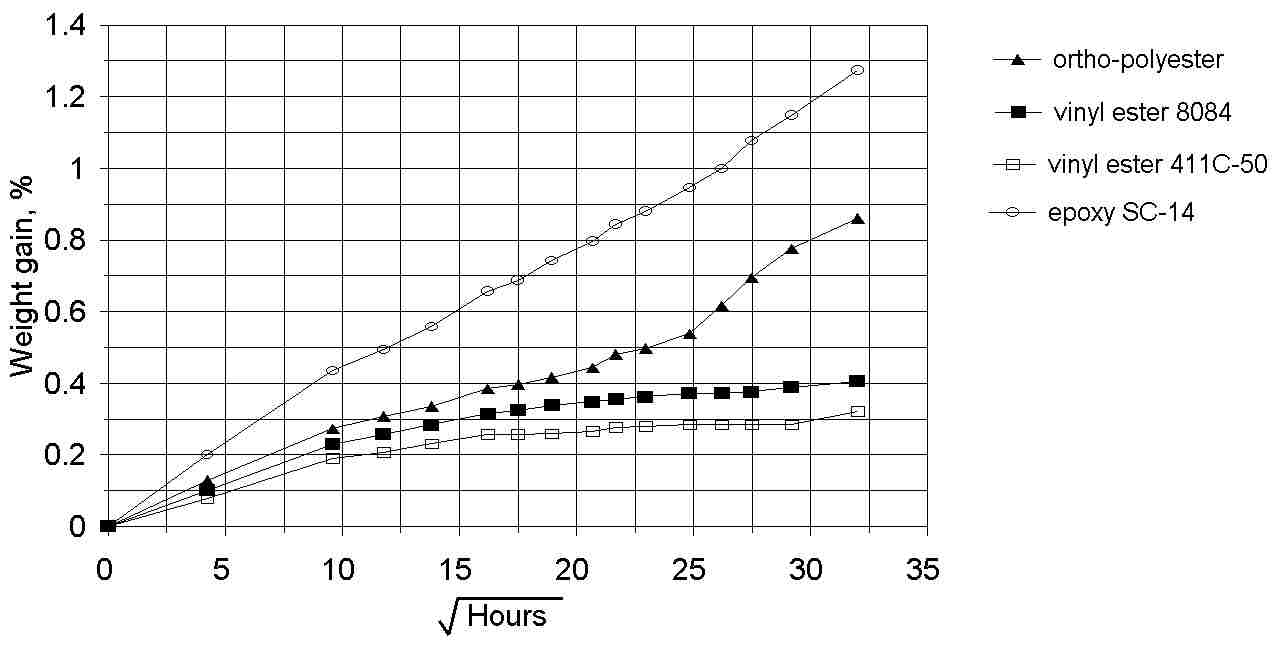

Frank Hagan Posted April 20, 2005 Posted April 20, 2005 Actually e[poxy is far more resistant to water absorption than polyester resin or even gel coat is by a long shot. The way I have heard it' date= the epoxy resin itself is not as hydroscopic as a polyester resin, but it will allow water to pass through it easier ("hydroscopic" meaning that the water infiltrates and stays in the resin). So a certain film thickness has to be built up with the epoxy to counteract its greater tendency to allow water to pass through. [edited to add the below info 7:55am] I found one of the studies I based my belief on, and its clear that the epoxy resin absorbed more water. However, Ray is right in that the water does damage to the polyester resins, whereas it doesn't cause as much damage to the epoxy. The attached chart shows the absorption, but the water is at 50 Quote
Frank Hagan Posted April 21, 2005 Posted April 21, 2005 The full URL to the study I snagged the chart from is at http://www.coe.montana.edu/composites/documents/18%202000AIAA%20Selection%20of%20Resins.pdf. Its a study of composites to be used for turbine fan blades, but the water absorption charts are the same for other studies (the link I gave above has simplified language in it, and they include a similar chart). Polyester body filler includes talc, which is hydroscopic, so it will fail in contact with water. Straight polyester resin, which absorbs just slightly less water than epoxy, is also degraded by the water. The epoxy is not degraded as much. There's a reaction within the cells of the polyester resin that leads to blistering when water permeates the resin, and with epoxy, that reaction doesn't happen. So why does a barrier coat work? Its a thin coating over the more susceptible polyester resin, so you would expect the water to go through the epoxy and still affect the polyester underneath. That's why I wonder if the elevated temperature for the testing is softening the epoxy (122 Quote
