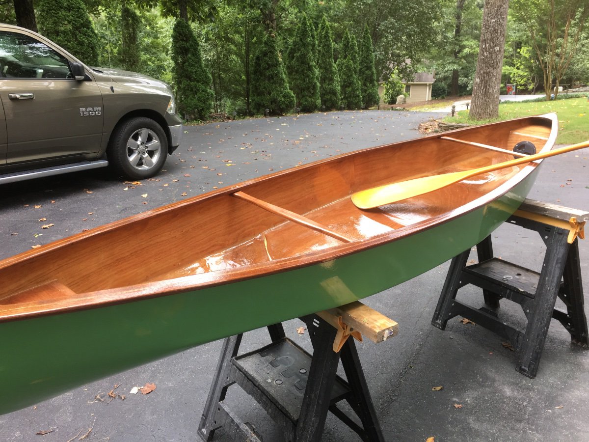

Don Silsbe Posted June 24, 2022 Report Share Posted June 24, 2022 Oh yeah. Not a biggie. I’ll post some photos of my build in the build photo page. Quote Link to comment Share on other sites More sharing options...
Bones Posted June 24, 2022 Author Report Share Posted June 24, 2022 Nice job on your Flyfisher. Looks great! Did you put foam in your fore and aft bulkheads, or is that storage? Quote Link to comment Share on other sites More sharing options...
Don Silsbe Posted June 25, 2022 Report Share Posted June 25, 2022 No need for foam. They were airtight floatation chambers. They weren’t big enough to be as effective as I would have liked. Quote Link to comment Share on other sites More sharing options...
