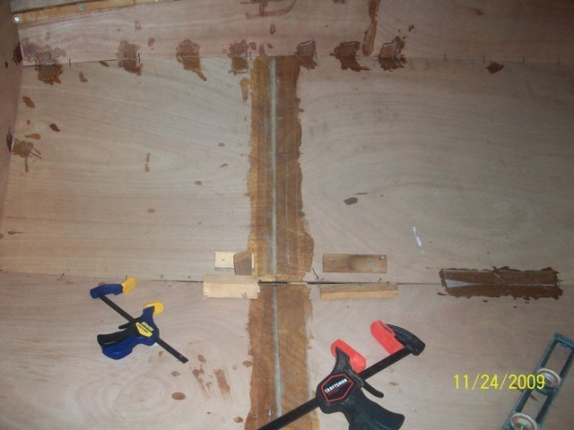

  3. Two Problems .... Any Ideas? 1) between temp frame and forward bulkhead I had some wires break and have a crack between hulls... Even using clamps and a board under to push up wood cannot get it to go back together.. Can I live with this problem? It could have been slightly miss-cut.

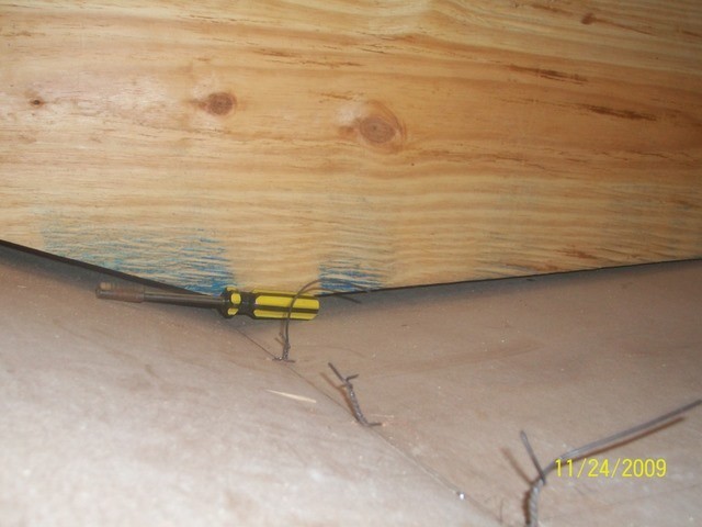

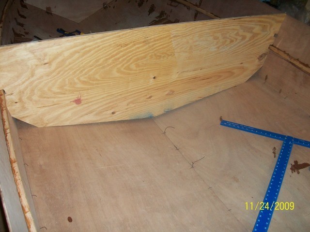

  4. To semi fix the forward bulkhead I've shaved a 1/8" off each side and almost 1" off the bottom... It seems to be fitting better now... The bottom lines for the foward bulkhead are almost straight now instead of curved.. Not sure if that's ok.
  5. On my forward bulkhead are the bottom cuts just supposed to be angled or curved as well? Curved it doesn't seem to fit very well. The other problem is on the port side around the bulkhead line the wood as popped/bubbled in instead of outword. Not sure how to fix it.. Even standing on the bubble didn't seem to work. The wood seems to be kicking my butt.

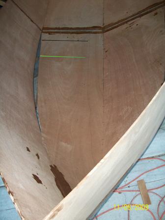

  16. From the forward end of the bottom I made it to long... Basically the curve forward is a foot to long. My measurement was done off the forward bulkhead instead of the last 36" mark. This made the forward bow point to far off. I've made my mind up... I'm going to cut the bow point fiberglass apart (used to butterfly), and reloft the forward 48" of the boat.. Should fix the problem. Lesson learned... I attached a photo to show.. The black line is what I should have made my twenty something inch measurement off on the bottom. The green line is the fwd bulkhead measurement which I used wrongly. I just roughly drew the colored lines in paint to describe the problem. It should be easy to reloft and cut the little bit on the bow. Later, Edward
