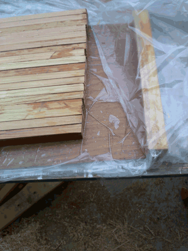

I'm almost 4 1/4" inches short on the centerboard in the trunk.. However, I've checked measurements and everything is correct on both trunk and centerboard. Do other people have this issue?? I have looked at the photos on the cd and it shows the centerboards fitting exactly. V/R, Edward

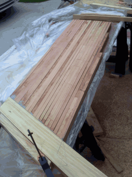

What kind of wood do you use for the top part of the centerboard?? The photos and plans make is loot like a single piece and I am thinking I need to laminate something then plane it down to 1.25" for it.
Someone should take you up on the tooth pick idea! It would be fun to see a toothpick laminated rudder handle or something
I am a IDIOT!! I was ripping 1x8's to 1.25"...... I guess I could keep on doing this and laminate more boards in.
Is the centerboard supposed to be 3/4" thick or 1 1/4"? The plans are confusing and looking at photos of others it looks like they are all different.. I have cut about 10 of the pieces I need to far for 1 1./4" thick.

Not sure from the plans but what is the centerboard width? 1 1/4" x???? on the ripped boards?? The alternating this is screwing me up because I'm thinking the ripped boards are rectangular shaped...
