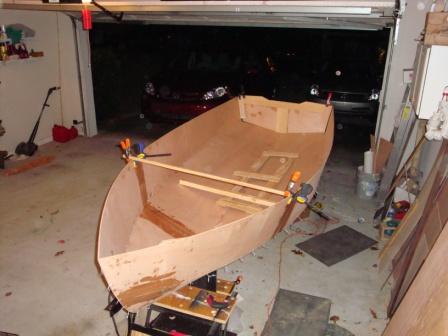

Things have been moving slow on the build. The weather in Hotlanta wasn't so hot. It was hard to get motivated to work in a cold garage plus I was worried that the epoxy wouldn't cure. So out came the measuring tape. I figured out that the boat will fit in the basement work shop. I was not building in the shop because I was afraid that if I built in there I might never get it out. But after some measuring of the window opening and my floor space I decided it could be done. So now my boat is in a nice warm shop for the winter and all my tools that were spread between the shop and the garage are happily hanging in there appointed spots. All is good. Which means I am making some progress. I have most of the inside seams filleted and taped. The gunwales have been installed. I still need to install the knees at the transom. When is it okay to remove the temporary center frame? Craig

Thanks to everyone for the encouragement. I would never have started this project without the supportive forum that we have here. I will be installing the bulkhead, temp. frame and transom soon. Will post more pics then. When does the boat stiffen up? After the bulkhead, frame and transom? Of after the "spot" welds are in place? Craig

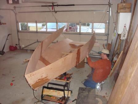

I had a busy afternoon. I recruited my daughter and her friend to help stabilize the boat and managed to get it to 3D. Man is my back tired. Here are some pictures.
After chatting with Graham I decided to attach the beam to the forward bulkhead before going 3D. Graham recommends it so that you have some solid wood to screw into. So I have everything set to go 3D. It seems like I will need at least one extra helper if not two. Can it be done solo? I can recruit the kids to help me out. Should I go ahead and screw in some reinforcement blocks at the bow seams for preventative measures? Thanks in advance, Craig p.s. I will try capturing the opening of the butterfly to video if possible. Will definitely have stills.

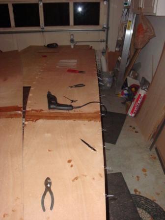

No new pictures yet. But I have been busy since returning from the mess-about. My bottom panels have been cut and I created the butterflies. I need to attach the transom stiffener before I open it up to go 3D. I already have the temporary bulkhead ready to go. A couple of questions for the collective. This is a Spindrift 12 - Cat Rig. From looking at the pictures and the plans there is a beam/stiffener at the top of the forward bulkhead. It is located on the bow side of the bulkhead. Should I attach this to the bulkhead before I go 3D? I couldn't tell how wide the beam needed to be so I made it 3" wide. Is that right? Width doesn't seem critical here but I wanted to check. Last question, I am assuming that I should be using epoxy to glue the stiffeners in place. Would it hurt to help secure them with some brads? Or is it better just to use clamps and epoxy? Thanks, Craig
Well I was able to correct the misalignment without having to compromise on the correct shape of the sides. I now have 2 perfectly matched side panels. Now to glue up the bottom panel without screwing them up. ;D Craig

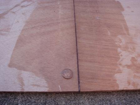

I found some 6 mil heavy duty plastic at the big box store. I glued the two side pieces together using the butt joint. I got a nice glassy smooth finish with the heavy duty plastic. But I might have a problem. I did not heed Graham's advice to use some finishing nails to keep the pieces from moving during the clamping process, consequently I have a small gap. Is this going to be a problem? Potential weak point? Misalignment during assembly? I can see where it would throw off some of the measurements. I have not cut the sheer yet, I was going to do that after the glue up. I have included a picture with a penny in the picture for scale. Thanks for any help, Craig
