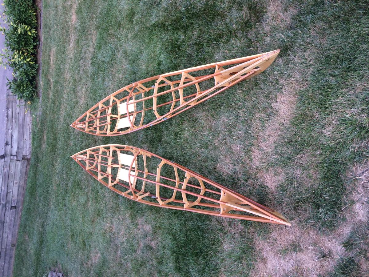

  3. Started skinning #1 today. So far so good but the end was a real pain.

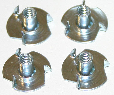

  5. Does anyone have photos of how they mounted the back brace? I think I just drill and bolt the straps to the coaming but, how far forward? Using blind nuts like these would make it an easy job. How have others done it?

  7. Second FROG plus linseed oil. Forward stringers are off to be scarfed longer and re-installed correctly. I'm getting pretty good at scarfing

  17. Second kayak is framed but we didn't get it outside for a frog. I saw someone post shots of laminated rub rails for the bow and stern. Having some left over walnut and maple, I coudlnt resist. I also found some nice #7 1" bronze screws with smaller finish heads to hold them on. Should look pretty and be functional.

  24. The skin actually adds all the stability to the coaming. It rests on the frames but the skin holds it solidly in place.
