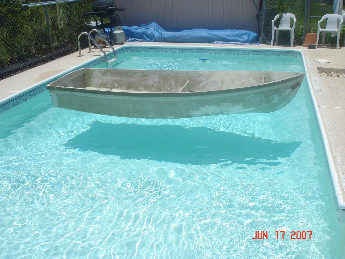

  11. OK, OK, it's an optical delusion! Just thought you might like to see a unique photo!
