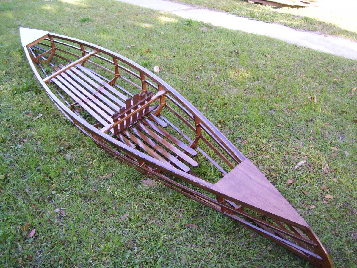

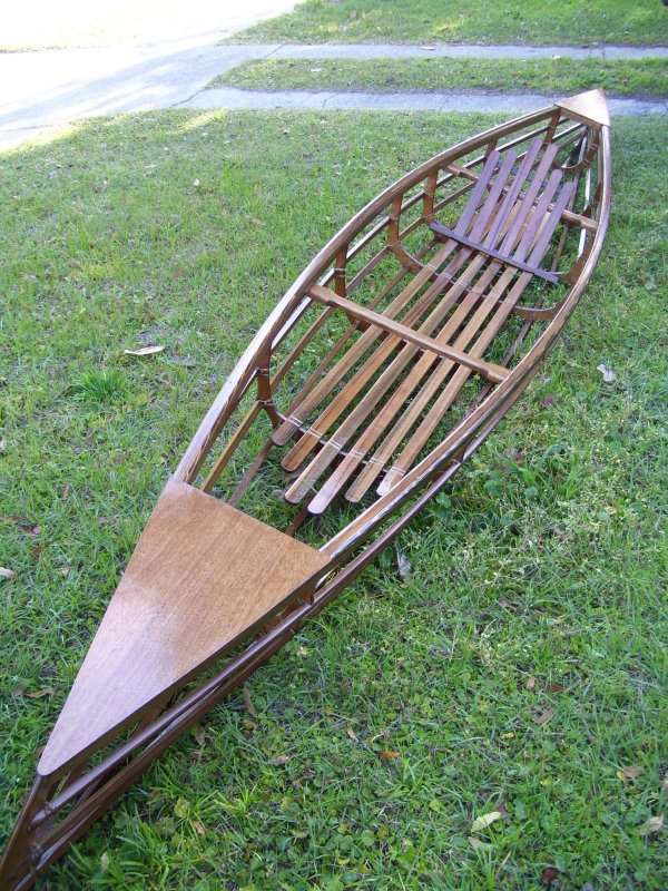

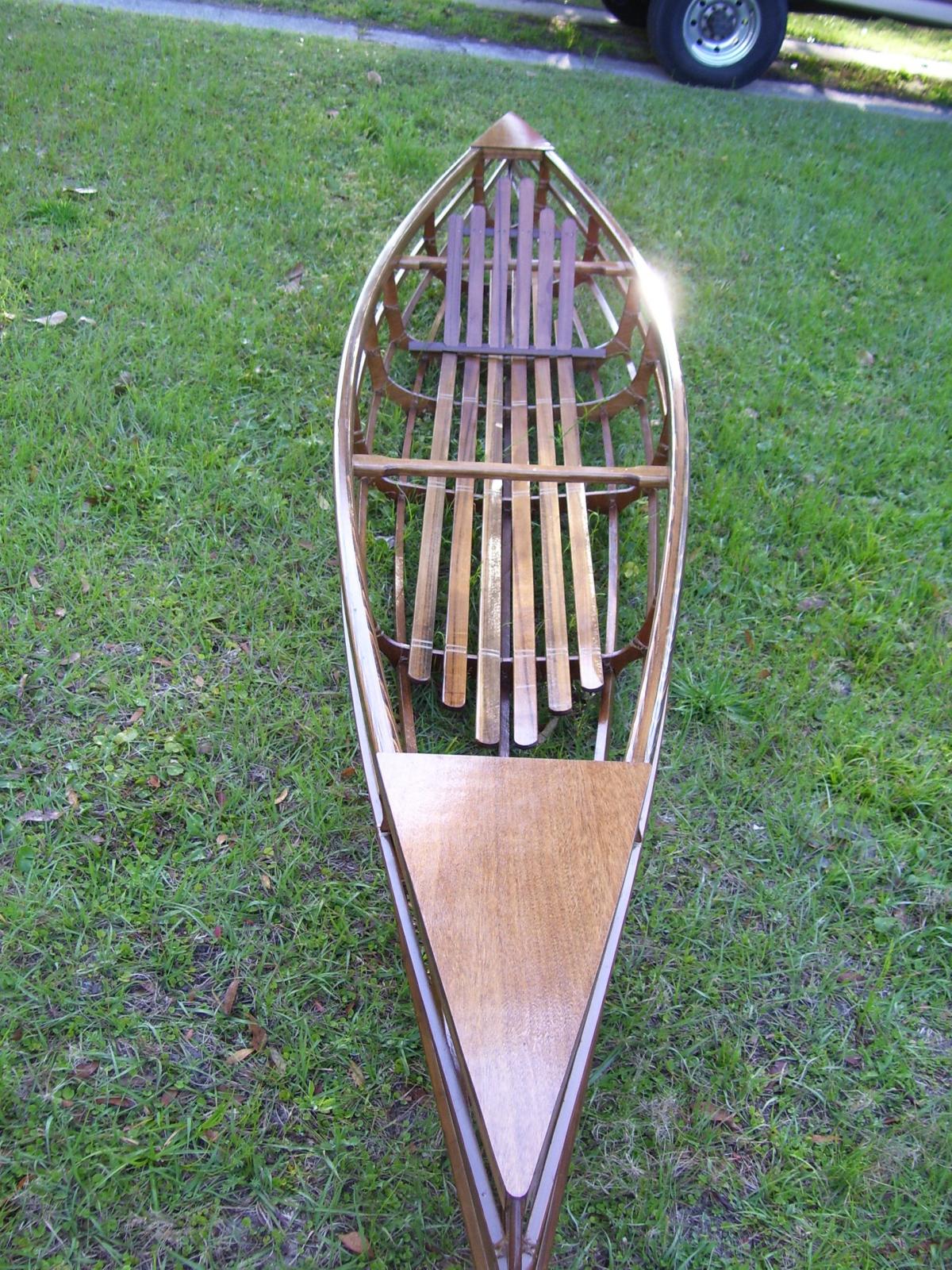

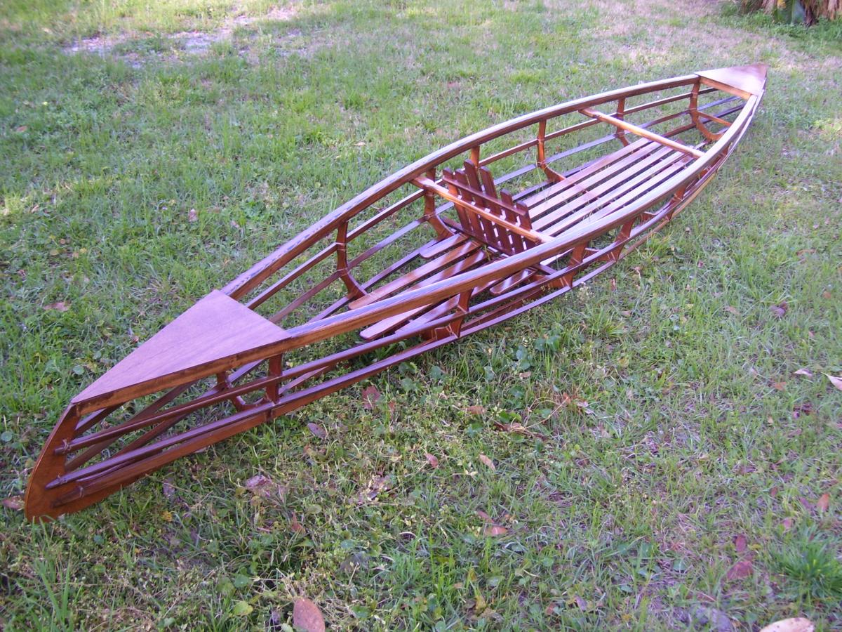

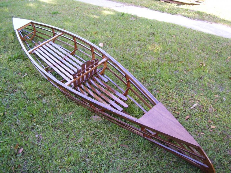

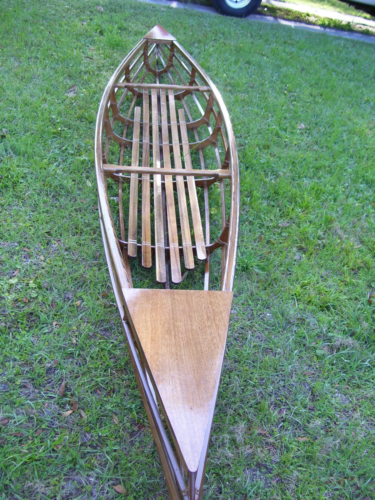

  14. First, thanks to ya'll for the advise and input here on the forum. Very helpful for a first timer! She's pretty much done now, I still need to turn her over and treat some bare spots before I skin her. Frames and breasthooks are okume, everything else is cypress. The backrest is scrap stringers and floors that I will lash in once I get her in the water and see if it's comfortable. Looks like the 11oz polyester I ordered from Jeff on Friday will be tomorrow, (that's fast) and the weather will have me stuck at the house so I may skin her tomorrow. Any insight here would really be appreciated...I'm nervous guys. I understand I won't be able to heat shrink the 11oz much so I need to get it tight and right when I sew it but...I don't sew. There are more pictures on my Photobucket album if you're interested:http://s204.photobucket.com/user/bobdsimmons/library/Stonefly%20Canoe?sort=3&page=1 Thank you again!
