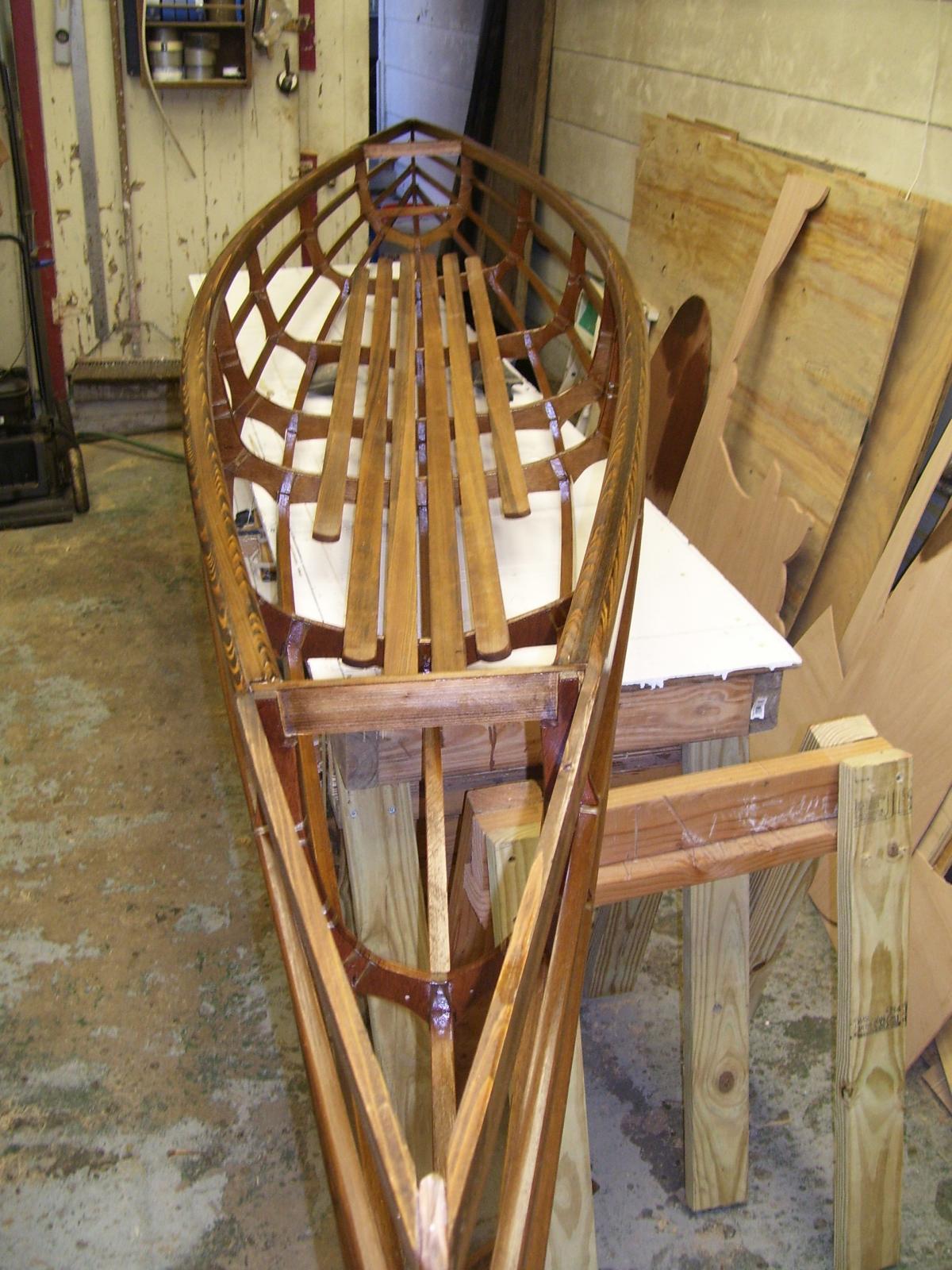

  10. Hey folks, I have the first coat on, thinned about 15-20% with MS and she looks great. I tell you though after I cleaned up I bent down and looked at the inside of the canoe (she's upside down) and my heart broke. From that perspective it looked like a drunk monkey painted the boat! Pretty disappointing until I realized the lighting was messing with the appearance. A couple hours later I could tip her up on the gunnel to get a good look and it's all I had hoped for! Two more coats (24 hrs. apart) and a week to set up. Getting short here! Thanks again!

  14. First, thanks to ya'll for the advise and input here on the forum. Very helpful for a first timer! She's pretty much done now, I still need to turn her over and treat some bare spots before I skin her. Frames and breasthooks are okume, everything else is cypress. The backrest is scrap stringers and floors that I will lash in once I get her in the water and see if it's comfortable. Looks like the 11oz polyester I ordered from Jeff on Friday will be tomorrow, (that's fast) and the weather will have me stuck at the house so I may skin her tomorrow. Any insight here would really be appreciated...I'm nervous guys. I understand I won't be able to heat shrink the 11oz much so I need to get it tight and right when I sew it but...I don't sew. There are more pictures on my Photobucket album if you're interested:http://s204.photobucket.com/user/bobdsimmons/library/Stonefly%20Canoe?sort=3&page=1 Thank you again!

  21. Thanks Fellas, I was able to get the stern on last night and the chines cut in. Very impressed with how the stringers are fitting into the frames and forming lines. So far just hand pressure and clamps, the books mentioned tapping with a wood mallet and watching the frames for stress but I haven't come across anything yet that didn't co-operate. Very impressed Jeff! The cypress is a joy to work with. I would say it's a little more dense than WRC. It loves a block plane but tends to gum up sandpaper. There are some pieces that were 'greener' than others though all were cut from the same board. I believe these were closer to the heart. They didn't take the stain until I heated them and wiped with denatured alcohol. I used these for the keel and chines and making the cut at the stern with a Japanese pull saw took some time, the teeth would tend to clog up and bog down. My first thought was the wood was wet until I lit some shavings, they burned well and no smoke so my guess is it's pitch and not water. (?) I don't really know. I'm on the fence with the 'pecking' though, it seems to be random and tooling exposes it. Aesthetically it doesn't bother me too much ( I am going back to get some more wood for the gunnels that doesn't have it though) but structurally I worry a little about what may be hidden inside the wood. I gotta say this lumber yard is awesome, one of those places hidden in the old side of town with a dirt driveway and several outbuildings full of treasures. The last time I was there the owner had to run out and told me to dig around and find what I wanted until he got back. I was in heaven! Deltabravo, Thanks for the insight. One more question - the Stonefly is 14'9". Seems like five yards may be cutting it close. Will there be enough stretch to accommodate the whip or rolling stitch ( I forget the name of it) on the bow and stern? Thanks again
  22. Hello Folks, I've been taking my time with this, figure it's time to post some pictures. The shop got real small and there's not much room to get back and make a good photo. This will have to do until I can get her off the workbench (strong back.) http://s204.photobucket.com/user/bobdsimmons/library/Stonefly%20Canoe?sort=3&page=1 Going to work on the bow and stern this evening. First experience with cypress and I like it. The 'pecks' were a surprise but I'm starting to warm up to 'em. I noticed there's an 11 oz polyester fabric in Jeff's store, any one used it? I'm leaning that way but just a little reserved about the difficulty factor, going to be my first time sewing anything, ever. Thanks for any input... Bob.

  24. I don't know what it is about work and boat building but when things are slow and I start building something the phone starts ringing. Maybe the trick is always have something going on in the shop. No complaints, but it makes me go hmm. I have the frames sanded and stained. Here's a link to them: http://s204.photobucket.com/user/bobdsimmons/library/Stonefly%20Canoe?sort=3&page=1 This afternoon I decided to go ahead and varnish them, the dull finish was screaming at me. I'll keep the PB album updated as things progress but progress will be slow for a couple of weeks. I'm trying to get a blog going so I don't clutter this thread. I did find a good source for kiln dried cypress so they will be the rest of the frame and maybe the strips for the floor. I've never worked with cypress, any input on how stable it is? How it takes stain? Things they don't tell you at the lumberyard?
