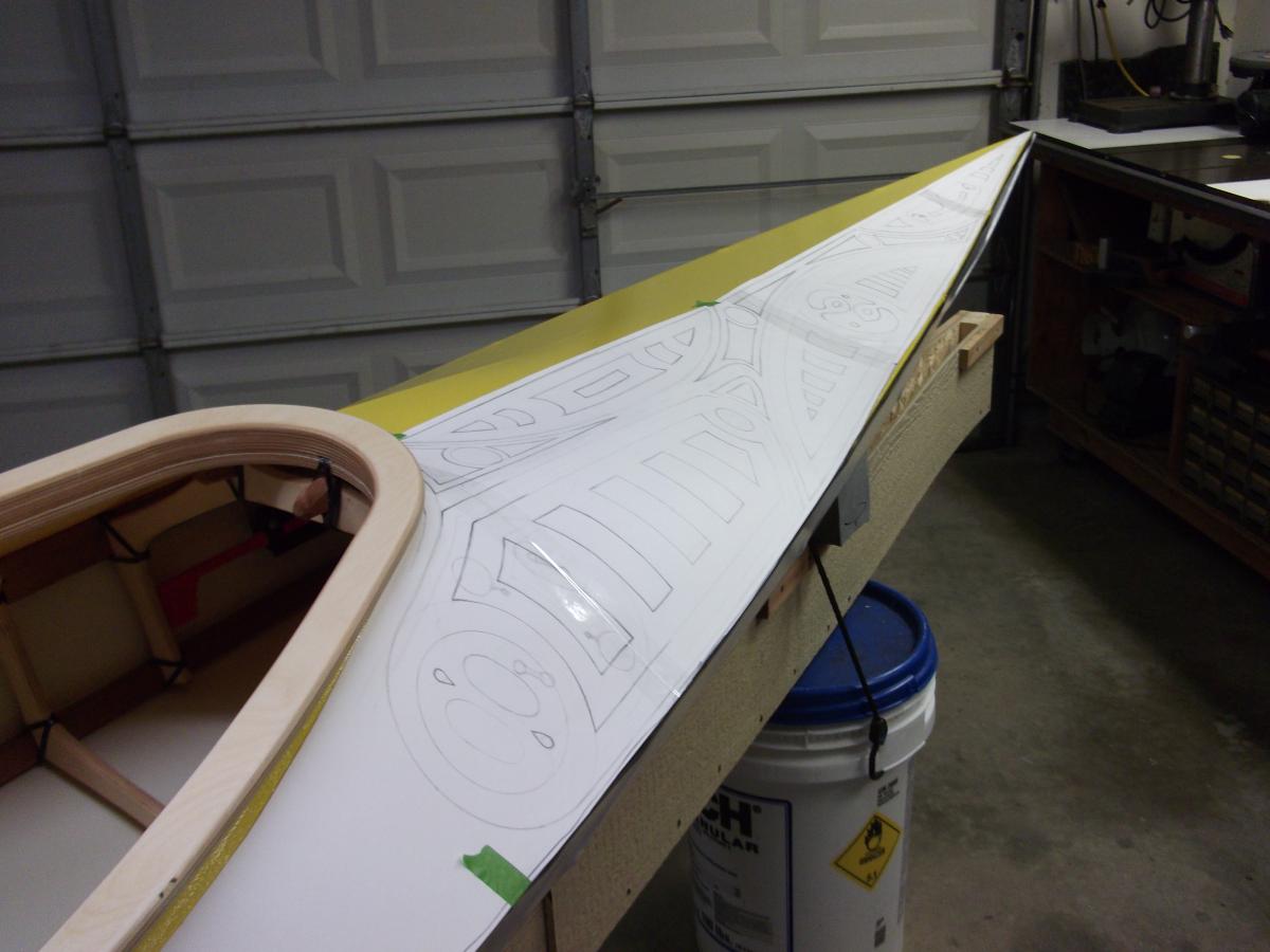

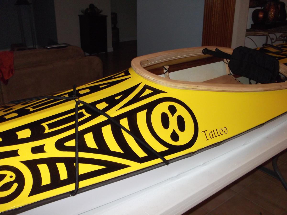

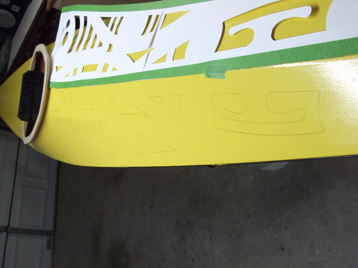

  18. Thanks Mr.Douglas, She wont let me hang it on the wall....yet....I have to wait until she wants something....then we compromise. Thank you also Uncler, Glad you like it. As for you questions 1. The hull is stapled to the gunnel with stainless staples witch do pull the fabric. I my case all the pulls disappered when I ironed it out and shrunk it. The black stripe covering the seem is vinyl tape over white 1" nylon webbing secured with outdoor carpet tape. It is all temporary because I did not realize it need to be black until after I painted it. The black webbing is on order and will be affixed with 3M automotive double sided tape. Like the stuff that keeps the logos on your car. 2. I used the 8oz poly that Jeff sells. Be sure to add the extra foot Before you place the order. Make his life easier. 3. First cut out a pattern that matches 1/2 of the bow or stern or one whole side. I used taped together construction paper. Second, create a design and cut it out. Next, I taped it to the center line of the topsides and traced it onto the deck with a pencil. I did not un-tape it, I flipped it over to the other side a hit repeat. Lastly, I masked off the design and painted with artist brushes. Tip: Automotive stores carry Frog tape in 1/4" and 1/2" wide rolls. You can follow curves very easily. The last photo shows the wrinkles the staple leave in the cloth. (can't find pointed ss staples) They shrank out completely. Hope this helps
  19. Wow. Thanks Again. The floor in the front is a cut up $10 camping mat from Academy covered in fake swede. It is removalable and is just to keep my feet warm from the water as i don't wear shoes while in the boat. I strap those muddy things on the deck. Note: The deck rigging is retractable because i don't use it that much and it cuts up the design, that will explain the knotted lines in the cockpit. I just used tung oil on the frame before skinning. Thanks again all.

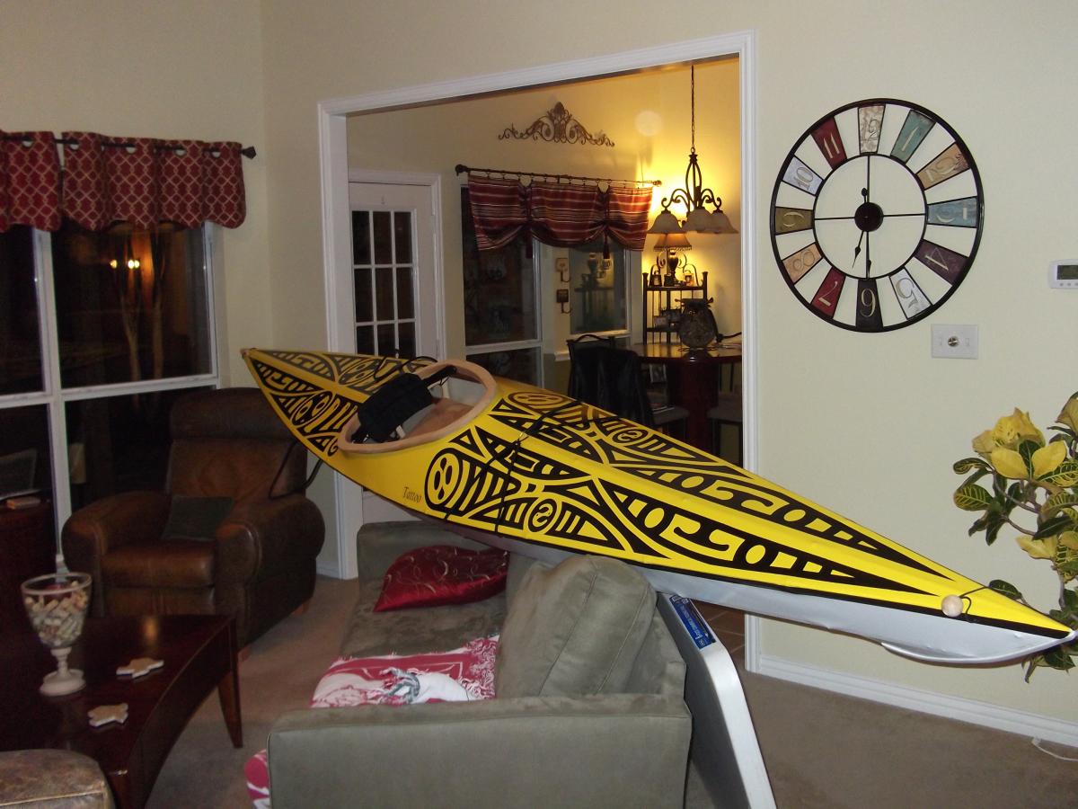

  23. Hello all, I have trolled this forum for a short while. I want to share what the SOF community made me do with my winter time. Originally, I was going to build a ceder strip boat with very fancy inlays and interesting woods. I have the skills and the tools but, I knew I would only want to hang it on the wall as a piece of art. I wanted a boat that was light enough for me to portage at least 100 yards if need be. I normally paddle only 3-4 hours at a time. The Ravenswood seems to be just right as to the volume I'll need for day tripping. I'll update how Tattoo preforms when the temps improve here in Mansfield TX. . P.S. Thanks for you help with my order Jeff.
