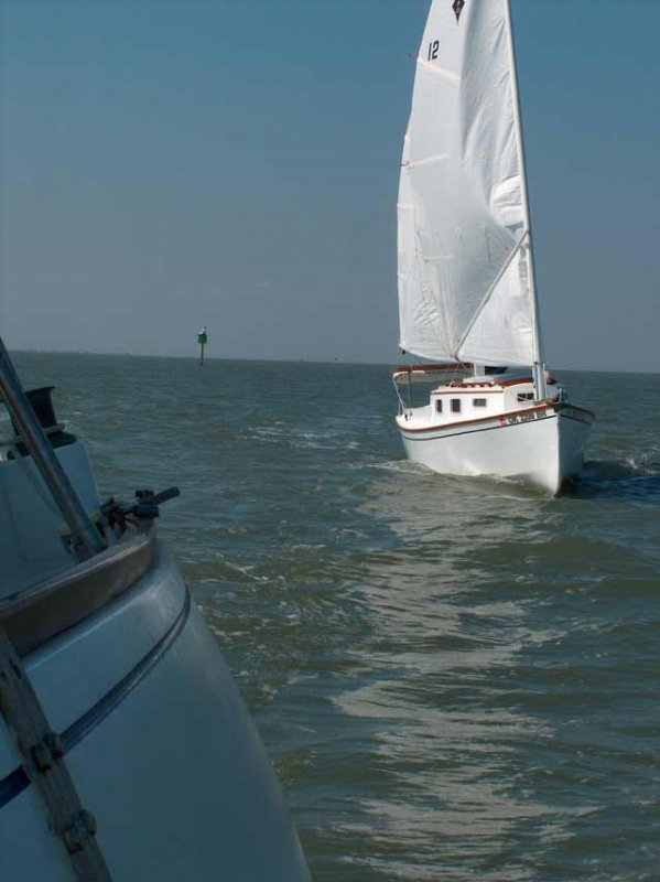

  5. Oh boy does she ever "sail on her feet" Here's a shot taken from Tehani- Hard to weather we were JUST edging Pilgrim- as soon as we started sheets she was in her element. I think you can easily spot the difference in heel angle between the two boats. Travis had JUST shaken out his reefs and we SHOULD have had one in
