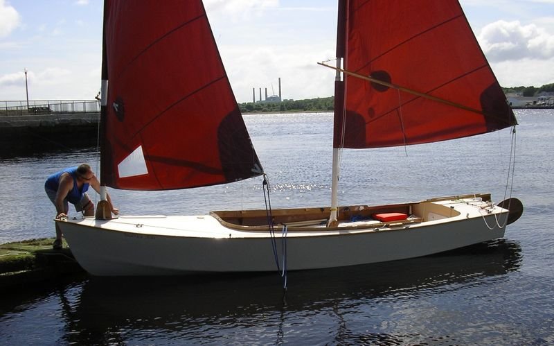

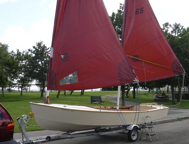

  14. Yesterday was the only nice day in a long string of forecasts. I took my two younger boys and the Beatrice Ann to Fall River and launched at the mouth of the Taunton River, and headed out into Mount Hope Bay. Winds were forecast at s 10-15 with gusts up to 20. Inspired by Joe Nelson's high-speed ride, I opted not to reef right away, figuring that between our combined 300lb crew weight, we could keep her on her feet. But the forecast was accurate, and the wave heights were underestimated, in my opinion. In short order my crew was wet and scared. My little protractor and plumb insisted that we weren't ever heeling much over 20 degrees, but even I had a hard time believing it. It didn't help that my crew stuffed themselves under the foredeck (I am still amazed at how they can do this) to keep dry, making them useless as dynamic ballast. The only way to keep the angle of heel to much less than 20 was to luff up. I dared not trim the sails in at any time during the long beat downriver and into the bay. I finally decided to have a go at moving the mast, which I've never done before. We anchored -- okay, first the boat anchored herself by tipping the anchor off the foredeck and tangling the rode around her cb -- just off the shore. I did the carefully choreographed dance of mast steppers and mast. And then we sailed neatly off under mizzen alone and as upright and easy as a duck. Sailing was good after that and we managed to make fairly reasonable speed. We finished up our ride in middle of the night, after some good practice in identifying lighted buoys. I also got to try out a homemade patent log I'm trying to perfect. I need to think about lowering my rig, I think. I made my masts about a foot taller than spec with the idea of leaving room to rig a cloth cabin/dodger that could be used under sail. I figured my 200lb could compensate for a little extra heeling force, but maybe not. In any event the cabin I had planned would create too much windage, so I'm scaling it back. Besides losing headroom, shorter masts will probably make it impossible to use the main in the reefing step--something I want to try first. The trouble is there wouldn't be enough clearance to use my mast stepper in the reefing step. Moving masts afloat would be nearly impossible without the stepper. A related question: I found it difficult to trim the (reefing stepped) mizzen in very far-- because the sprit comes past the thwart where the main sheet is rigged, there is a lot of downward and forward strain in sheeting it in. How do others deal with this? Using the original mizzen sheet would be very awkward. I thought of putting an eyebolt through the sprit a little ahead of the aft end, and tying the mainsheet to that. If I try to use the main in the reefing step the problem would be similar, but much worse. Experiences? Ideas?
