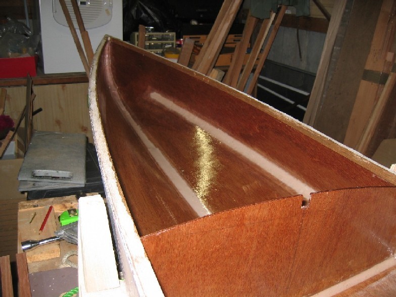

  1. Hi all, The Lil Diva hull has not progressed much since my last posting - I have been far too busy on a new project at work, and also took a month off to visit some of the USA. Awesome trip, with my only regret that I couldn't get up to visit Graham. Next time...... Currently the Lil Diva hull is still waiting for the foot brace pieces to be fitted before I put the deck on. The little hull is cute, and lines are sweet. I have started building a Grand Diva as well - the butterflies are cut out and being joined - resin drying as I type this. Will be 3D after this weekend. Those 18' panels are long and floppy to handle! I intend to progress the building of this Grand Diva quickly to the stage I am at with the Lil Diva, then complete both the Divas together, just like when I did the 'Twins'. I bought a digital camera while on holiday, so will be able to capture the building process 'on film' a lot easier and faster than before. I hope I can post pictures faster than before.... Once these two are complete, I'll get borrow one of the original Divas and photgraph all three of them together. Regards, Chris.
  2. All right, all right, keep your hair on, you impatient wood carver.... Progress to date has been slow - too many other factors taking my shed time. However, the inside of the hull has been sanded, the seams filleted, taped, smoothed and resined a couple of times. Next step is to mount the seat supports and I'll paint the insides - the same as I did with the Twins.

  5. Nemo wrote : How many sheets of ply do you need for the Lil' Diva? Answer : None - I have plenty already. Seriously though, only 3. Two for the hull, bulkheads and coamings. One for the deck. Construction is progressing, hull is complete and getting sheathed now. Photos will be posted in due course, but I promise far more quickly than the Diva album took.
