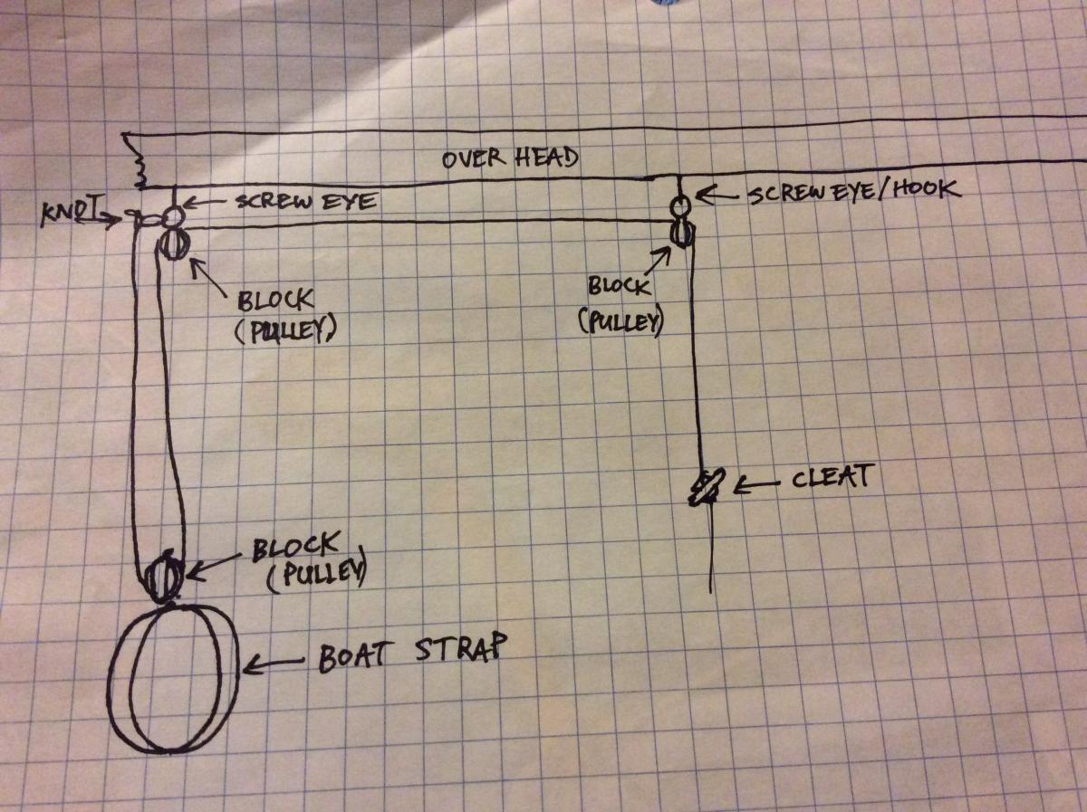

I don't know what commercial lifts cost, but it isn't terribly expensive to build your own:
Lay your kayak/canoe on the garage/carport floor directly below where you intend to hang the boat.
Make two loops of rope (or strap) around the boat at the points at which you want it suspended. I spaced mine about eight feet apart for a seventeen-foot kayak.
Screw three lag screw eyes into garage ceiling joists: one directly above each loop around the boat and one half-way between the first two. ("Half-way" is just for illustration. I'll comment later about other placement for the "turning pulleys".)
Attach one 1 1/2" to 2" pulley to each of the end lag screw eyes and two pulleys to the center one. Or, use a double block.
Tie a pulley to each of the loops around the boat.
Tie the end of a 40' line to the eye at one end of the boat. (I'm assuming a 9' ceiling.)
Run the free end of the line down to and through the pulley you previously tied to the loop directly below the eye, run the line through the pulley tied to the eye next to where you tied the end of the line, run the free end of the line through one of the pulleys tied to the eye near the center then down to a cleat attached to the wall.
Repeat the previous process on the other end of the boat.
Grab the two lines and pull to hoist the boat.
Cleat both lines to hold the boat in place.
Parts:
2, 40-foot lengths of 1/2" polypropylene line. Lowes sells 50-foot hanks of suitable rope. The excess can make loops around the boat and provide line to tie the pulleys to the eyes. I used some old rock climbing carabiners to attach the pulleys.
6, 1 1/2 to 2-inch pulleys. I'm saying "pulleys" not "blocks" because "block" implies marine hardware. Lowes sells suitable pulleys.
3, 3/8-inch lag screw eyes. If your garage does not have a ceiling, you can tie the pulleys directly to the trusses.
1, cleat to tie off the lines.
The two pulleys on the standing part of the line give a two-to-one mechanical advantage; you'll only be exerting twenty pounds of force to lift a forty-pound boat. If your boat is a Kudzu design you can throw some sand in to get it up to forty pounds. :D
I have three boats suspended under my carport using this system: one against each wall and one 2 1/2 feet out from one wall. For the one hanging away from the wall, the line from the upper pulley to the turning pulley runs diagonally across the ceiling and does not interfere with the lines for the one against the wall. The turning pulley does not have to be at the center. To avoid interfering with a door, one turning pulley is near one end of the boat. Measure to be sure you don't cut your rope too short if your ceiling is not nine feet or if you run lines horizontally across the ceiling.
Had a drawing, but can't get it to load. Here's a rough illustration of one end of the lift.
line tied to lag
screw eye or hook

That is basically what the bicycle lifts are with the nice feature of a built in lock to catch the rope. I found them cheaper than I could buy decent pulleys. But I only buy them at discount prices, never retail.

A more drawingy drawing for you...
