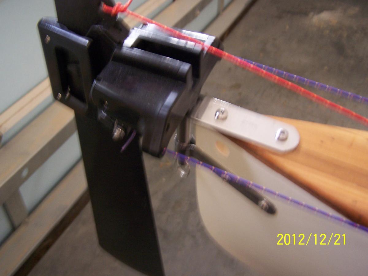

That is Graham's recommendation for a rudder installation on the Dive kayak. Do an end pour and then drill a 3/8" hole for the rudder post. Right. My freehand perfectly vertical drilling skill is suspect, and I figured blocking and leveling the kayak under my drill press would be a major PITA, so on Diva #123 I went with the bolt on SS gudgeon. (see pic).
On Diva #125 I decided to do the pour. But not the drilling. I glued in a small wedge of wood with a forstner bit 3/8" dead end hole about 3" down, used a 3/8" dowel to establish vertical, glued on a strip of scrap ply to form a vertical dam, and then installed my drill cheater = a 3/8" shank bolt with the threaded part cut off. Then I did the filled epoxy pour. When cured I fired up the blue tip wrench, heated the bolt and removed it, leaving a nice vertical 3/8" hole! (see pic of bolt and hole)

If you look at pic #1 on the left you'll see the SS gudgeon I mounted on the kayak tail to receive the rudder post. That method leaves a 2 1/4" gap between the kayak stern and leading edge of the rudder.
In pic #2 on the right the rudder post will go into the hole and I'll have to shave about 1/8" off the kayak tail to provide clearance for the rudder. A nice snug fit. The epoxy pour saves weight over the SS gudgeon, and saves $$.
The end pour method is good for pointy tail kayaks, might not work on blunt tail kayaks since the steering bar part of the rudder assembly is about 3" wide and would need to be set back far enough to clear the transom.
