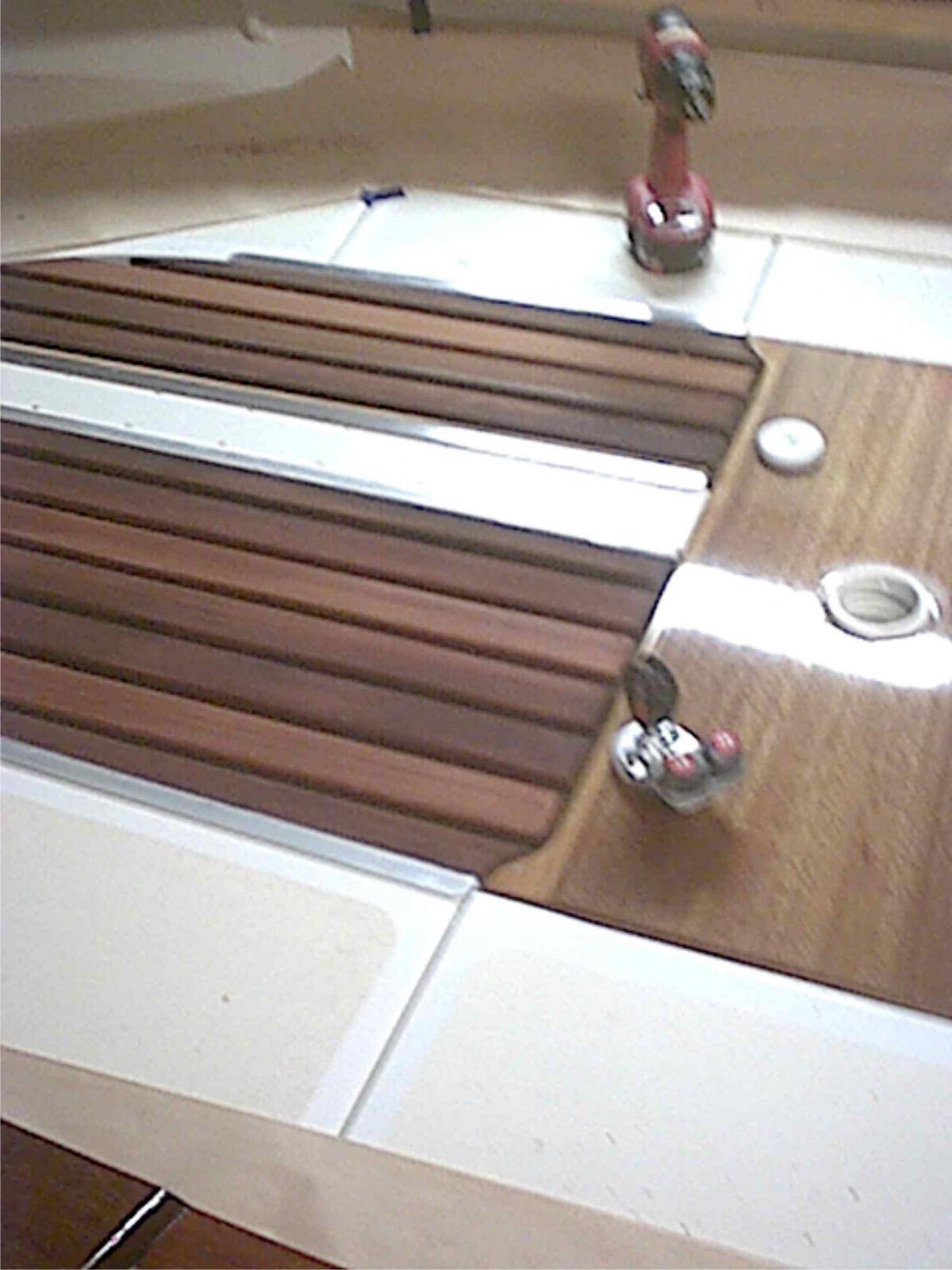

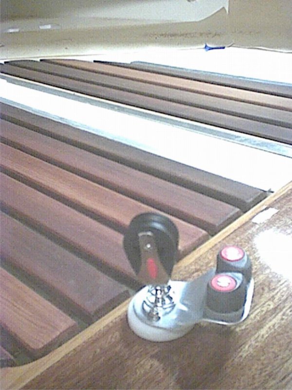

I used cedar ripped off the edge of cedar posts from the local big box store. I eventually settled on 3/4" by 2" stock over a few stringers. This is the forward cockpit area with them raised up. Very light weight and oil finished. 1" x 1/8" aluminum angle stock is screwed to the slats to keep them in the raised position.
