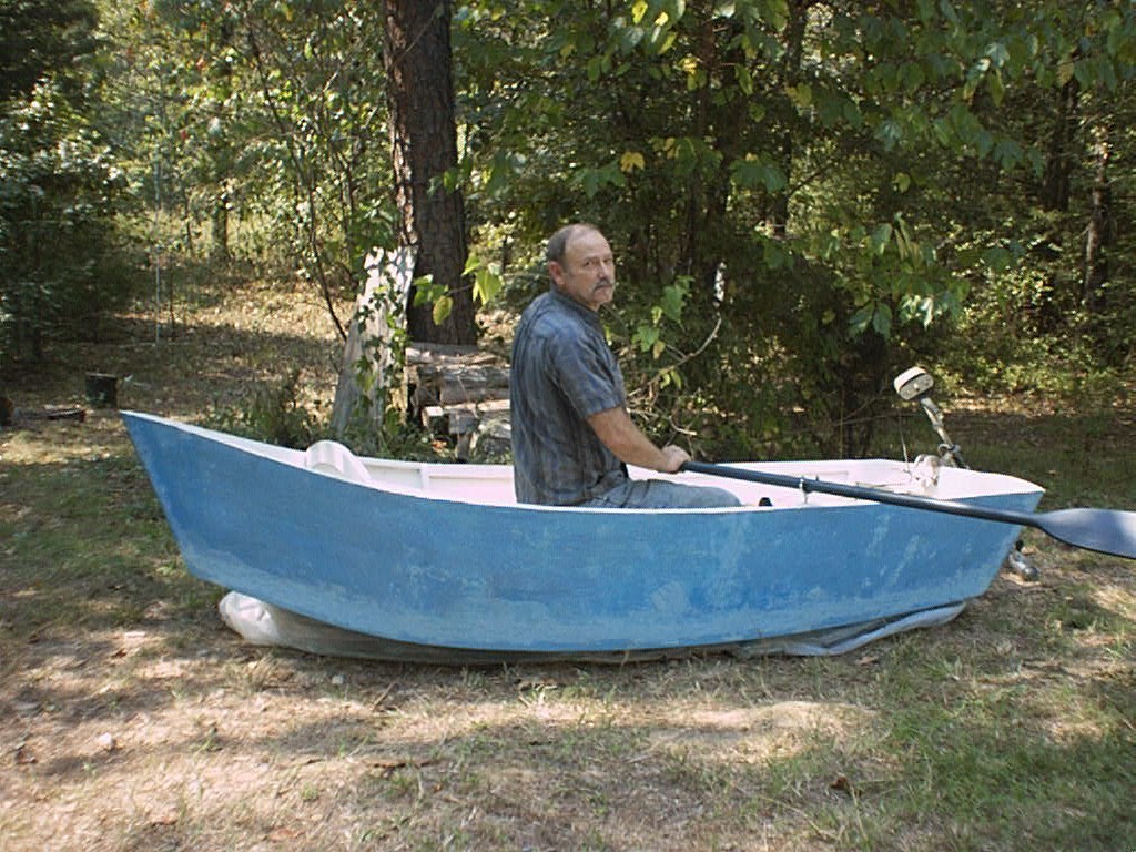

It's an original design, about an eleven foot skiff, flat bottomed, or a slight 'V'.
A few years ago I built an eight foot skiff, it's fun, but its just too small.
I'm thinking about stretching it a little.
