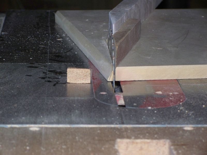

Biggest thing with your jig is you need to get rid of all the base on the right side of the saw blade. Run it though the saw and that way it will be flush with the blade. Then the cut off will fall onto the table instad of staying on the sled. It would be very hard, but not impossible, for the cut off to get caught by the back of the saw blade if it is on the table, on the sled if you can pull it right back into the blade and witll be launched at you.
...Or shut the saw down after each cut...
That is a nuisance to do.
If the sliding table were to "some way" be left intact on the right side of the blade only beveled away from the blade so as to cause the fall-off pc. to slide away frome the blade would be handy...
I doubt you could get any where near enough slope for the cut off to slide.
I can see no reason to leave the table on both sides of the blade. It's just asking to get hurt. With the sled having zero clearance (being against the blade) it makes it extremly hard for the cut off to behind the blade once it falls down on the saw table. Not impossible, but extremly unlikely.

Yea, I am going to harp on this. You need to clamp your peice your cutting and you need to run the base all the way through the saw and get rid of that material on the side of the blade. It serves NO puprose being there.
Plus what the other said too.
