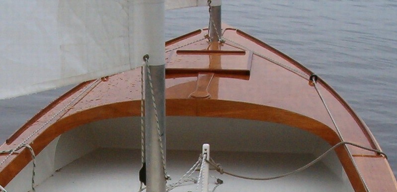

Jim,
Have you considered a toe rail? It gives a better foot hold and you can have fastenings around the fore deck perimeter and cover them up with the toe rail. Because there is a fair amount of bend for the deck at the bow, it is good to have some mechanical fastening as I have seen the ply peel back around the edge. In the picture there was also a fancy cover board down the center line to cover the center fastenings.post-127-0-85904500-1307246274_thumb.jpg
I had not even thought about it and the last thing Wow it looks great as well, I can see using fir for contrasting highlights at those points. I do not want any peel back, I can picture that as a bad bad disease. Yer great, thanks again Graham.
Jim
