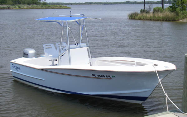

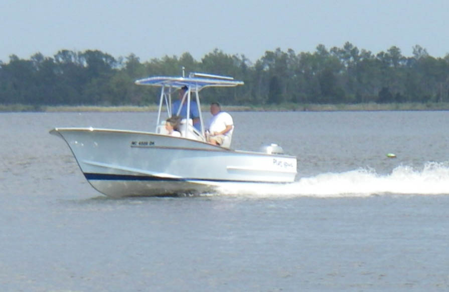

Tom Lathrop Posted July 6, 2008 Posted July 6, 2008 B&B is off the air again. Another lightning storm last night that took out the Vandemere tower -- again. Twice in one week is beyond statistics. Another forecast for tonight. Standing by. Graham's new design small sport fisherman boat was launched a couple days ago. It is 20 feet LOA and was built near Vandemere. As you can see, it sits right on its lines and looks great. Engine is a Honda 90 which has not been run to WOT yet. Quote
Howard Posted July 7, 2008 Posted July 7, 2008 Nice boat! Looking at the photos, this boat incorporates a spray rail at the chine. Have been wondering if something like this would work on boats like the Core Sounds to "dry them up". Got the idea after reading from some about the spray they throw in a chop. Quote
Tom Lathrop Posted July 7, 2008 Author Posted July 7, 2008 Nice boat! Looking at the photos, this boat incorporates a spray rail at the chine. Have been wondering if something like this would work on boats like the Core Sounds to "dry them up". Got the idea after reading from some about the spray they throw in a chop. I doubt a chine spray rail would be a positive addition to a Core Sound sailboat. A spray rail would definitely contribute drag though whereas, in a powerboat, spray rails generally decrease drag. Powerboats operate mostly in a level side to side attitude which allows a spray rail to do its work. The CS boats are not particularly wet anyway. Compared to low deadrise or flat bottom skiffs, they are dry. Spray means that you are going somewhere fast enough to make spray, so enjoy it. Quote

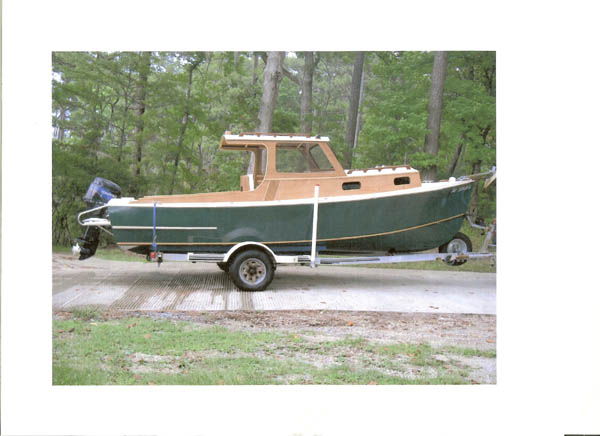

Tom Lathrop Posted July 10, 2008 Author Posted July 10, 2008 Yep, we are in a series of daily storms with much lightning. So much that I am very reluctant to get caught out on the water when the storms show up on the weather radar. Here is the latest edition to Graham's stable of powerboats. This is a little lobsterboat designed for the original builder and owner of the first Princess 22. 20 feet LOA and Chick named her Princess, of course. 20 mph with a 25hp outboard and looks great. Looks like she will be a neat overnighter and weekender. Photos are captioned 18' but just ignore that. Quote
Garry Posted July 11, 2008 Posted July 11, 2008 What's the best way to clean drool out of a keyboard? That is a beautiful boat! Any plans for making a set of plans available? Quote
