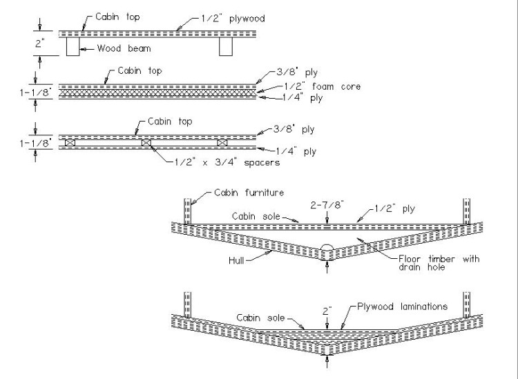

Garry Posted May 9, 2006 Author Posted May 9, 2006 Ray, I forgot to answer your question about the floor and cabin beams: Tell me more about the laminated floor and cabin beams to gain extra headroom, sorta interested in that option on the 26. Graham suggested to gain an extra inch or two, I could eliminate the floors for the cabin sole and laminate plywood directly across the center of the hull to build up this area for the required strength; using the top of the plywood as the cabin sole. The thickness of the plywood would be less than the depth of the floors and sole gaining an inch or so in headroom. Along the same lines, the cabin beams can be eliminated and the cabin top thickness increased until it is self-supporting. This can be accomplished several ways: add plywood layers, make a sandwich with plywood-foam core-plywood, or make a sandwich except use wooden spacers to separate the top and bottom layers (for an I-beam effect). Here are a couple of sketches to show what I mean (representative only, dimensions are pure guesswork). Quote
Greg Luckett Posted May 9, 2006 Posted May 9, 2006 Gary, You might also explore placing the cabin beams above the roof rather than below it. Quote
Garry Posted May 11, 2006 Author Posted May 11, 2006 Right, Greg, that would be another option. I tend to lean toward the foam-core sandwich for the additional benefit of the insulation from the sun beating down in the tropics. Quote
Greg Luckett Posted May 11, 2006 Posted May 11, 2006 This is my second try at this. The darn power went off about 3 hours ago right before I could post. The beams on the roof make a good place to lay things such as a dinghy, but the smooth surface of the panels would look better. I think the trade off of eliminating the beams might compensate for the added weight of the foam core panels. Quote

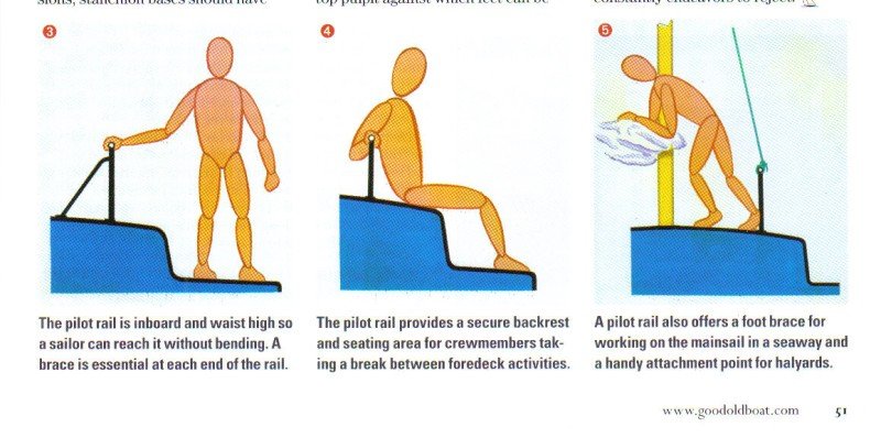

Garry Posted June 20, 2006 Author Posted June 20, 2006 I agree that the shrouds are useful for hanging onto, but they are really not well designed for that. They are outboard when you need something inboard, they are thin when you need something easier to hold onto, they flex and the load you put on them when hanging on can really stress the connections. My intention is to install something I've seen called pilot rails. The idea was presented in an article by Alan Lucas in Good Old Boat Mar/Apr 2006 issue (I took the liberty of scanning an illustration below). Pilot rails are sturdy handrails located inboard on the cabin top. They would be in the right place for grabbing, sturdy, easy to hang onto, and a great place to attach a tether from a harness. You often see them on serious heavy weather boats such as commercial, Coast Guard and pilot boats. They would be easier to grab and hold onto than the typical wooden grab rail which is usually compromised by boat poles or fenders that prevent easy grabbing anyway. It would be great to have them waist high but I will probably compromise and lower them to 6-8" above the cabin top. They would also be great for lashing a dinghy or other cargo on the cabin top. Quote
Greg Luckett Posted June 20, 2006 Posted June 20, 2006 Garry, I took a look at that article, thanks for pointing it out. It seems that you need a big enough boat to still have deck to move about on inside the pilot rails, as shown. Maybe the solution is taller hand rails, which would be the same thing as pilot rails on a smaller boat? Something like a stern or bow pulpit rail, except straight for the length of the cabin top? Greg Quote
