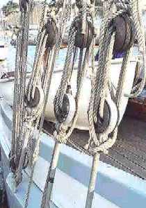

Oh I mean deadeyes :wink: I need some pictures of deadeyes for my new rigging. I wish to remove the turnbuckles that are really funky to "look". I have seen some rings and loops but want to be able to adjust them. I have not had any luck with the google feature. Thanks in advance.

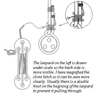

OH, how do you get them to hang straight and connect to the chainplates?
The easiest way is like Phil has done it or with a 90 degree twist shackle .
Many years ago, I made up a set of deadeyes from galvanized wire and teak. The wire was hard soldered and lashed, looking much like tarred line after painting. The bottom eye was strapped to the chain plate in a traditional fashion (swiveling eye), but the top eye had an "all thread" coupler epoxied inside and an eye bolt run through from the top to receive the shroud (thimbled). This provided a deadeye that looked salty, but had the adjustability of a turnbuckle, by sticking a fid in the upper eye (to hold the shroud) and turning the deadeye to slacken or tighten.

Thanks everyone for the shots. Phil, I still marvel at your workmanship on your boat. Smoothy, your project needs its own link on Stevenson website. 8) I hope that it works out for you in stabilty, too. The rigging is fairly simple, and uncumbered by a lot of fittings, so I think I will come up with a deadeye and block rig for it.
