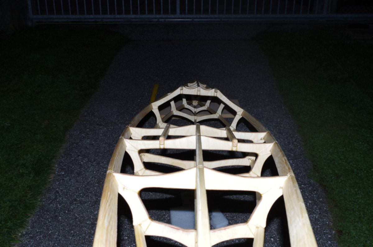

the title explains it already pretty well. On the strongback, the frame was level and square. Now I took it out of the strongback and it developed a rotation along the long axis.
I took some pictures to show it. I can not really tell what is causing the twist, my guess would be the bow.
Stringers are spruce and the weight of the frame is 8.4kg, overall it feels rather flexible. I tried to fixate the bow and rotate the stern clockwise, and it helped a little bit but I think it will go back.
Is there a way to fix it? How do I find out what is causing it?

Today I check all the frame distances between each other and also with respect to a "zero" point, which is a nail in the middle of the keel in the cockpit. Still, all the distances are symetric. Which makes sense, as I double and triplechecked while it was still on the strongback. Also, the gunwales were always level, and also the frames were vertical when checked with a waterscale.
When installing the stringers I always tried to match left and right stringer so they needed an equal amount of force to fit to the frame.
So my theory is, that one diagonal opposing pair (e.g. top right gunwale and bottom left stringer) is not so well balanced (one is bending inwards too easily, where as the other is resisting this much more). Don't know though how to find it, and also I don't know what I would do with it if it would fit.
Anyway, now I put it back on the strongback and level the stern. Then I measured carefully with a waterscale going forward one frame a time and it seemed like  most of the twist happens where there is long distance between frames where the cockpit will be. Doublecheck this by leveling the bow and measuring backwards, and voilà, I ended up in the same spot. Now I applied some torque with some improvised levers and bungee cords as shown on the picture, and wait for a few days.

@labrat: This sums up my thoughts in one sentence, thanks! English is not my first language. If I look carefully at my gunwales, the port side is nice and has straight grain, but the starboard side has a funny pattern in it behinde the cockpit.
One week of applying quite some torque did not help at all, did not try with steam though.
Today I spent some time trying to figure it out again with a friend. We tried multiple things, e.g. opening the gunwale lashing in certain frames and bending it out (with a shin), but whatever we tried did not match what we predicted. It's kind of tricky, because there is always translation and rotation (=levering) and that in both directions of the change).
One more thing worth mentioning maybe, is that most of my scarfs were not good enough. They will hold becaues they have a neat fitting, but the are not as straight as they could be.
Also, all these changes did not have a lot of impact on the frame, which is good as it shows the frame design is rather robust. Thanks for the design @Kudzu!
In the end I opened the bow gunwale lashes and planed away a bit of the port side gunwale. This helped a little bit, but I did not dare to go any further as it might skew something else.
Anyway, as I am out of ideas proclaim my curlew frame as ready for skinning! As I am out of ideas mostly. If it turns out to not track well, I can still add a skeg to make it go straight.

Alright this took me a long time to figure, to eventually I decided to just replace the suspect gunwale, and it reduced the twist significantly. It is not gone completely, but I decided to declare it straight enough for skinning.
After inspecting the bad gunwale, I realized there is a scarf at the height of the seat, which was not perfectly straight but shifted to a slight angle during glueing.
This must also have caused some misalignment to the rest of the frame while it was still on the strongback, at least that would explain the remaining corkscrewing in the frame.
