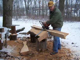

I have a hard time using all those accumulated shorts of various hardwoods for kindling. But they were taking up too much space so I bit the bullet and here are the results.
