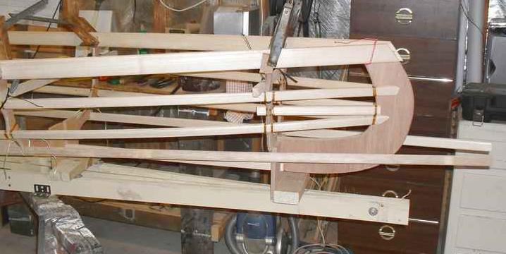

This is how I am going to solve the bow problem I will attach some 3mm ply to a notched area in the inwhale and the side of the outwhale that also screws to the top of the stem. I will then fill the gap level to the top of the outwhale with western red cedar. Should work just fine. Pictures in a day or two. Mike John

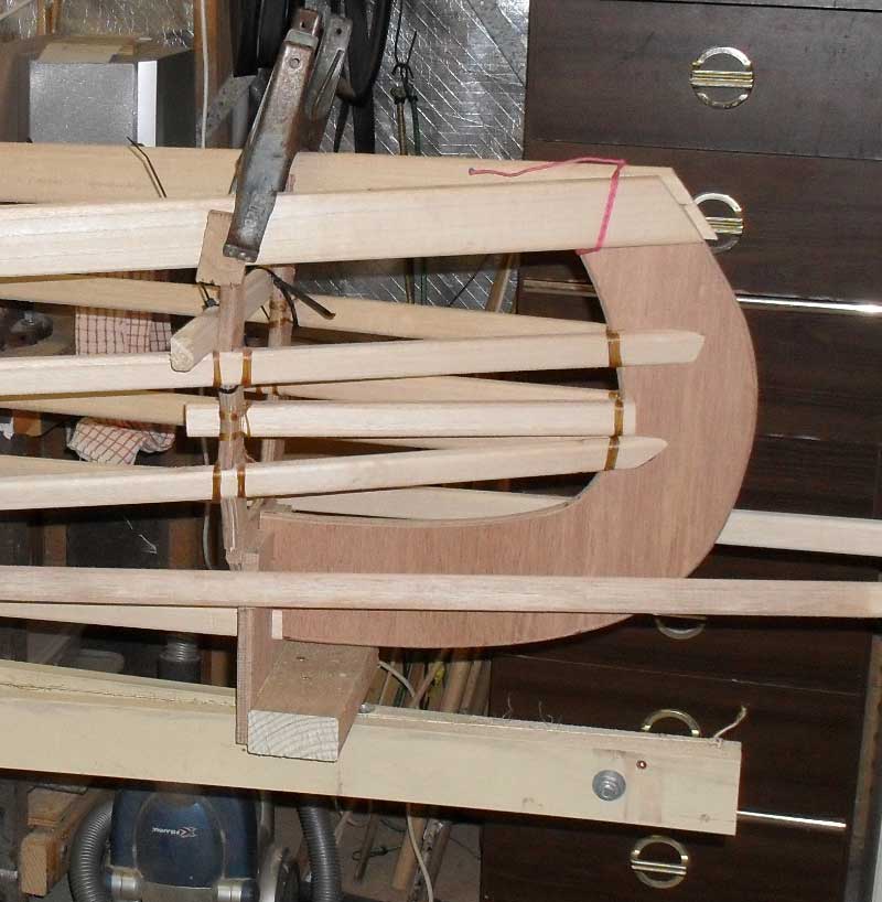

The outwhale is on. Of all the things I could have done wrong, one of them resulted in this. It's not a major problem. The outwhale still makes contact with the stem and I can run a screw through it was well when all is considered. A little tweaking with the breasthook to make the stem and outwhales make fluid contact and all will be fixed. The little shelf will add a lot of strength to that area but even the two little extra stringers on the inside stiffen it up, if I leave the shelf out. If a better builder than me does the boat there will most likely be no problem. I usually leave a little extra on top of the stem for such occassions but I forgot. I think that is a good idea but a second build will prove it was my fault most likely. Anyway, if you build Tangerine leave extra on the top side of the stem and trim it flush latter. The next build should tell us more. Mike John
I have been beavering away at about 2-3 hours per day. All the stringers are lashed except for the bottom three because the first bracket is in the way. I will remove that bracket when the gunnels are on and do the bottom two stringers and what I can of the keel stringer. I will finish the keel stringer when I remove the boat from the stongback but it was easy to glue it in so I did. I'm stuck. Here's the thing, I just don't know what to do with the outwhale at the bow? Assistance please. The pink sheet hung on the window was done by somebody's wife sometime and I am not responsible. The drawing is a rough sketch by me. Mike John
