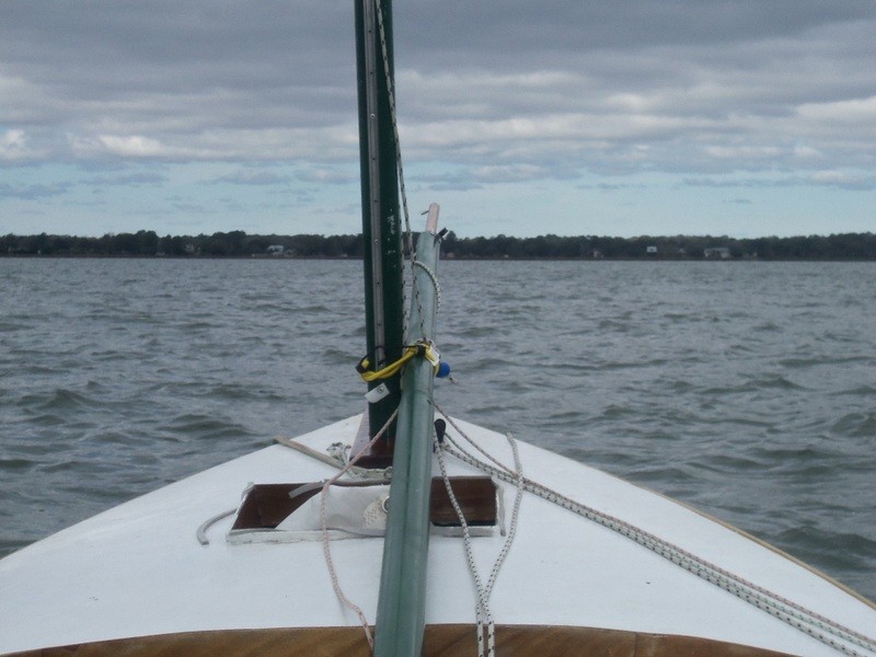

Here are some photos of the fun demasting today in about 12knots of wind shooting through some pretty fun waves.

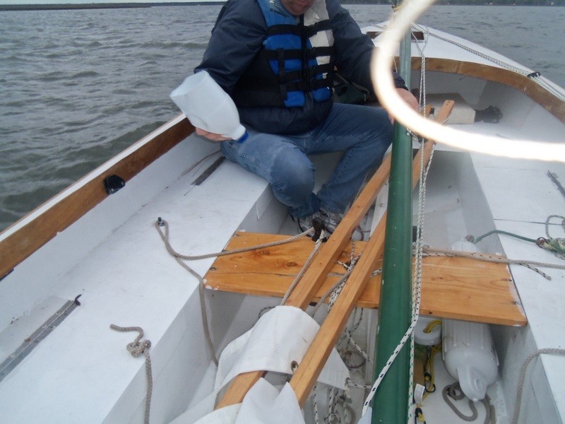

We where headed east shooting down the river with a north east north wind that was only gusting a little bit. Next thing I know the mast is sideways to STBD off the boat. I started the outboard and had Joe pull down the main sail. Next we headed for the south shore of the marsh, and the wind picked up the mizzen sail and lifted the mast back up. For the next 5 minutes while my 7 year old steered I kept the mast up (it was actually very easy even with wind on the sail) and Joe worked on getting the sail down.
We ran up onto shore and took down the aft mast then motored back up the river. One of the problems was when the mast step failed it twisted the autobailer sideways. We where taking in a decent amount of water until we managed to secure it better but still bent and twisted.

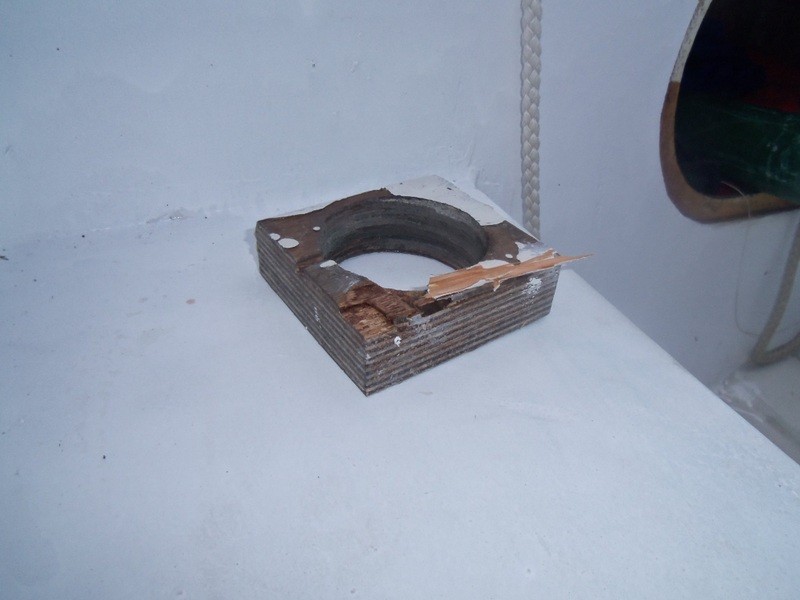

Contributing Factors:
1) Taking boat into heavy seas briefly day before with 30knot gusts.
2) Adding a cap on the mast bottom that was slightly narrower in places then mast, might have but more force higher on the step.
3) using small screws to hold it in place instead of bolts.
4) one or two joints failed but looks like a combo of that and a small piece of ply that delaminated.
Positives
1) The seat did break and crack sideways, but looks like it happened from the end of the mast lifting up.
2) Spot was secured under mast, but survived.
3) some of the epoxy joints held on boot but ripped wood out underneath.
4) ripping away from centerboard trunk didn't put hole in boat.
5) boat was still very stable with mast down hard and sideways.

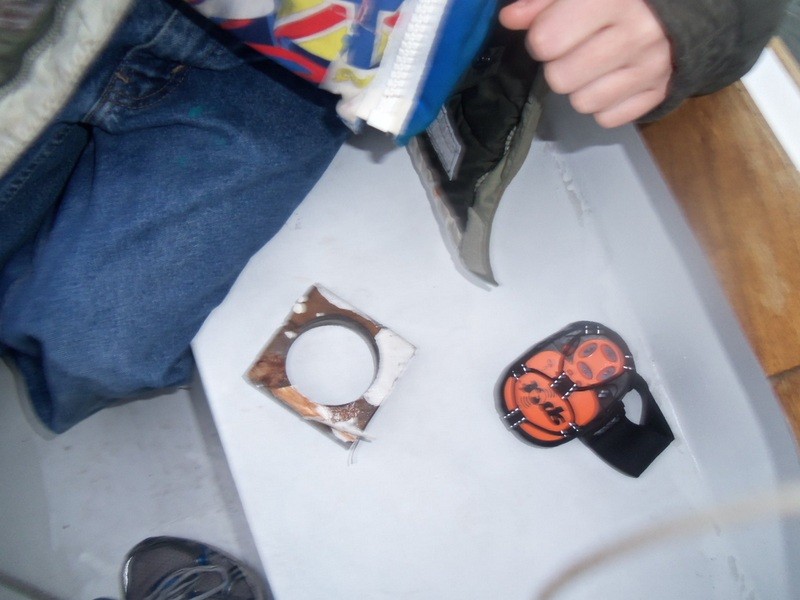

I've had the end cap fail, and once bent the mast against overhead powerlines, but not yet the step. Mine isn't thru-bolted either, but secured with honkin' big screws. Best check the condition of the thwart while you're doing the repairs: I'd worry about the twisting stesses on it from the accident.
I really think the 30knot gusts the day before might have been a significant factor in failure.
For my temporary seat on the side of the center trunk with the mast I'm reinforcing/laminating the board with another 3/4" piece but going length wise instead of across on the grain. I'm also using pine this time as local lumber place doesn't have fir or spruce. Of course the strengths aren't that far different especially with it doubled up. Fr the mast step I'm using the one that came off, sanding it down, reepoxing inside and outside, then reattachment will include thickened and bolts into ss inserts.

Studying your mast step, I see that it is square, probably 3 1/2" x 3 1/2" rather than the 3 1/2" x 5" specified in the plans, reducing the glue surface by about 50%. I cannot see the four 1 3/4" screws that go down into the keel batten. There only looks to be about 20% of the glue surface that pulled wood when it broke.
Boy that Designer sure does have an eagle eye... I never really looked closely at that pic, but he is right about the dimensions...
When i fit that step in I have it glued to the keel batten and also to the centerboard trunk and I fillet all around to the trunk and to the baltten and lay 3 strips of overlapped glass tape in the fillet and I use the screws...
