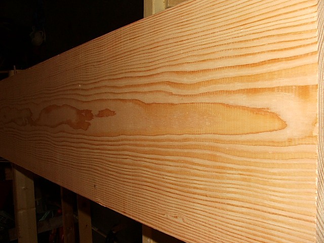

BobSmalser Posted March 31, 2006 Posted March 31, 2006 Look at the size of the ring cups in the center. Those are pith boards. You can also see it on the board surface...two qsawn sections bisected by a flatsawn section. These shouldn't even have been sold, IMO. On my mill, I cut out all that pith and tight-cupped surrounding wood and give it away for firewood. I mill short of it, cut it out as a 3"-wide board, and begin the next board beyond it. It's those itty-bitty cups that cause the warping. Plus some piths spiral in the tree, and you can't see that when milling boxed heart timbers....so all boxed heart wood is a crap shoot as to whether it'll remain straight. But all's not lost. Simply rip out those tight cups and use the clean but still slightly crooked wood with staighter stock in your birdsmoth spar. The straight wood'll pull it in and the epoxy will lockt is all in straight. Maybe 2-3 warped pieces out of 8 will work fine...and stagger them inthe assembly, eh? Quote

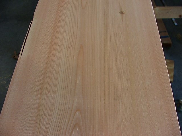

Arnie Eaton Posted March 31, 2006 Posted March 31, 2006 I live in western Montana. Now we don't have any large DF trees in this area, so, when I was ready to build my birdsmouth mast, (Vacationer), I ordered from my local lumber yard some DF for the mast. What I got about a week later was four pieces of 1X6, two were 18 feet long and two were 20 feet long. Clear of ANY defects and the cost was , with shipping, $104.00. I really didn't expect to get such nice stuff, but apparently this wood came from northern Canada or from Alaska. I still have one board plus a 1X3 pc. I have never sean such nice stuff sense I left the Seattle area many years ago. I would really talk to the manager of any lumber yard most anywhere and see if he (or she) would go to the same extreme as the local guy did for me. Sure did pay off for me anyway. Could be just luck as well. Quote

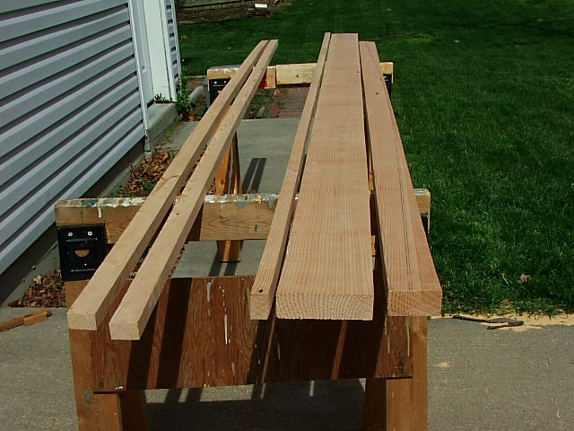

Howard Posted April 2, 2006 Author Posted April 2, 2006 Under the category of "the rest of the story", or what a difference a day makes, I've attached a couple shots of what become of that warped board with pith wood shown on my first post. I just hit the board a few passes with a skilsaw. Don't have a table saw where I live. The two pieces on the left are the pithwood and are total junk. They came out warped and with splits. The black spots are flys. No knots in these pieces. The other three might have some use, unless they take off and warp on their own. Time will tell. The one on the right has a boom laid out on it and the layout eliminates all that pithwood The middle piece has no use planned, but it has some decent wood in it. Rings are a bit coarse on it and sapwood runs up the left edge. The skinny piece may get used for cleats, blocking or just test pieces. I do that sometimes. It is mostly clear with a few small knots. It was part of that pith wood piece. It may warp, but I hope to block it up into a bunch of smaller pieces before it does. So yup....it started out ugly, but unless it continues to warp, it may turn out ok after all. Quote
