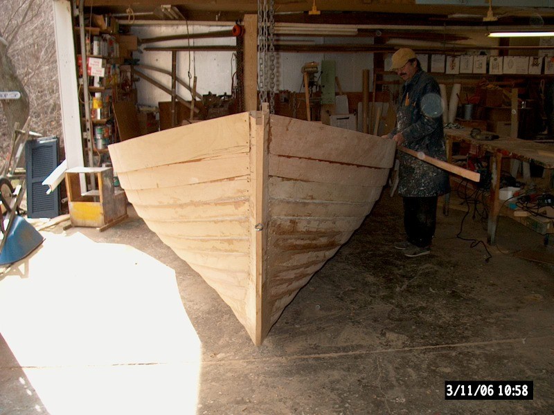

Yes, Mike, 3.7, but actually all of Section 3. I am glad I had an instructor teach me this because reading about it makes my head hurt too... :lol: At least I can understand it now, and this method works better than the method all the other books talk about. Iain's book is the only one that I have found teaching his method. If you go to the March/April 2006 WoodenBoat magazine and look for The Landing School ad on pg 19, you will notice the planks start out wide at the garboard then progressively narrow moving to the shear. At least they are evenly spaced and look ok, but using Iain's method, the plank widths will all be of equal size and look more uniform (my preference).

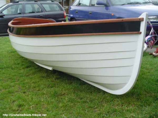

Another example of planking mistakes causing uneven planking is the Puffin built by an amateur. It is still a very nice boat, just not of a quality to be sold by a professional boat builder.

Mike,
Are you planning to scarf the planks while in place on the boat? If so, I am not sure how this could be done and have the hull fair out nicely.
Boat building class method: We first make a pattern using the cheaper Luan 6mm stuff, then transfer the shape to the expensive wood, positioning the sections (two 8 foot, and one from 4 to 6 ft long), laying out where the scarf joints need to be positioned, then scarf the pieces and then glue them together. Once the plank blank scarfs are hard, we again lay the pattern on and draw out the shape, then using a circ saw, we cut the plank, then put it back on the boat to double check. At this point the plank is about 20 foot long. One person can do this but it is much better to have two. Use planking clamps attached to the molds to rest the plank on in order to get it into the proper position.
At this point the stem cut can be determined. Leave the transom overhang alone for now, but cut the plank stem angle, leaving some proud of the cut line mark, then using a right angle grinder with a 40 grit to custom shape the plank. This point is where each plank needs to be checked for alignment with its sister on the other side and to make sure you are not getting creep in the widths. A 1/8" or 1/16, for example, creep on each plank will cause the shear to move up on the stem that amount times the number of planks.
The rest is a matter of beveling the previous plank, putting the stem and transom gains in, and fine tuning the position and edges to be fair. Incidently the inside edges should have a small bevel to relieve any sharp corners. We use a low angle block plane for this.
I have probably left some things out, but this is the gist of it. :)
