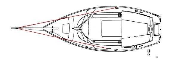

Noel,
This is an overhead drawing showing a practical layout for your leads. You might consider doing something similar.
This routes the Peak Halyard and the throat halyard to the right side of the cabin top with the Peak to the outside. The jib halyard is run to the left side of the cabin top.
In this drawing, seperate sheets are laid out for the jib/genoa with block locations on either side of the deck and aft of the shroud locations for a Genoa and just about at the forward shroud for a standard jib.
If you are using a clubfoot on your jib then i would run that lead to the outside of the jib halyard on the cabin top. This puts all the lines in close proximity to you when you are single handing it. And the two you need to reach most often on the outsides where they are easily reached quickly.
I would recommend cam cleats to secure all of these as they release easily but hold well otherwise. You can place fairleads at the front edges of the cabin rails to help keep things straight and neat. You will need turning blocks to route the halyards and sheets to the cabin top.

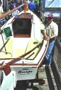

That was a great tip from our Host, Frank. 8) Here on Capt. Jake's "Fire
Escape". He has since re routed all his halyards to the cabin top and added a second "bag" to hold the lines on the right side.
Routing the halyards (and topping lift) to the cabin top is on my to-do list, right after I get the furler and lapper installed.
