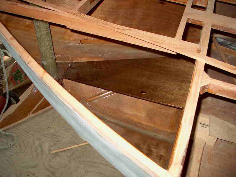

I accessed the forepeak a number of times during the EC without any difficulty. When Bill built the boat he made one really good addition, he made a floor out of 1/4" ply which is split down the centerline, level with the mast step back to the bulkhead. It gives a large area for stowage that is not too deep and with a finger hole near the centerline you can pick it up and lay it against the hull as if it was hinged when you need to get underneath, it will even come out the hatch. The only addition to make is a pair of small cleats under the aft end of the mast step and one across the bulkhead positioned to make the floor level.
The only modification I have yet to make is to cut my starboard floorboard to fit around my oar tubes.
The picture shows one side in place.
