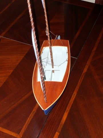

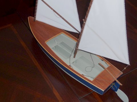

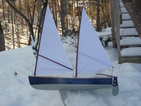

  6. Hey thanks G! Hull and sub-deck are 1/32 Baltic birch ply Deck is Mahogany veneer that I got from the Woodcraft store. One of the problems of model making is that with most woods the grain isn't to "scale", but the mahogany looks better and is a ton cheaper per square inch than the birch, it just does have any structural strength which is why I went with two layers for the deck. Framing and centerboard (etc.) is basswood and a little spruce To top it off, I went with solid walnut masts. I was going to do birdsmouth spars, but... I've learned so much on the forum, so a big thanks to everyone. One trick that worked great even on a model was to use a laser to mark the waterline. Man, was that a whole lot better than trying to do it by eye. I'm sure I'll be asking a ton of questions when I start building the real thing. Now if it would just stop snowing here in Hickory, NC -- I left Michigan for a reason!! Dave Z
  7. Yep, that's right folks -- got the plans in December, started building in January, and now it's ridin' high on the water in February. * Okay, so it's not exactly full size, and the water's a bit frigid. But it was a blast to build and I learned a ton. I tried to do most everything according to plans - including (some) fiberglass and epoxy. Most of the framing is in there, too. I skipped the hatches because I didn't want to mess up the beautiful mahogany veneer on the deck. I still need to figure out how to put some nice numbers on the sails. Can't wait to build the real thing :grin: (Trying to attach pics for the first time...)
