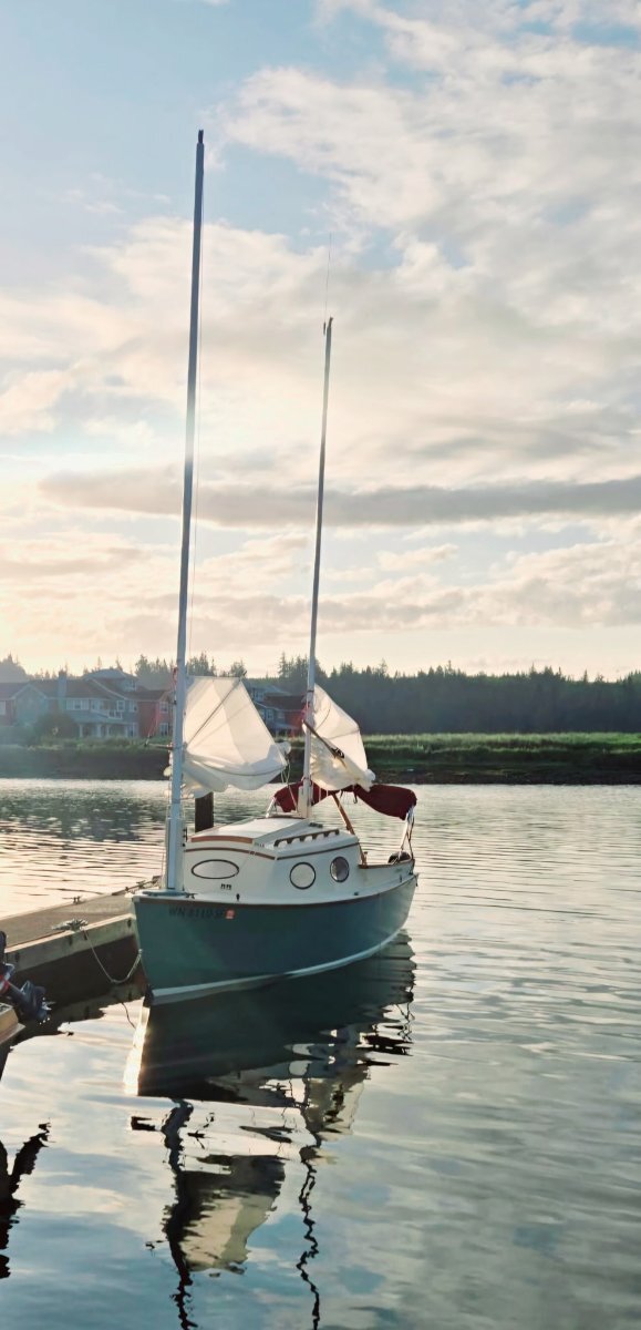

  2. Winds were light but that's typical for July in Puget Sound. I managed to fly Clementine's mizzen staysail a few times and was happy to see someone caught it on camera. The staysail is a bit of trouble to set, but the extra 0.5 knots of boat speed is pretty special when the rest of the fleet is moving a 1.5 knots. I hope to do the trip again next year and would encourage other B&B boats.

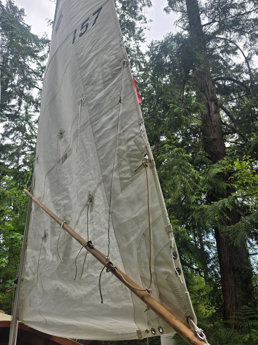

  7. Got my photos up, but lost my text. Replacement sails for my CS17mk1 were slightly longer in the foot, so I came up with the above solution. If you zoom in on the boom end you'll see a small u shaped shackle. It is kind of a pain to assemble but helped me avoid making a new boom. Drilling holes in the boom was probably not a great idea, but it hasn't been a problem. Randy Jones

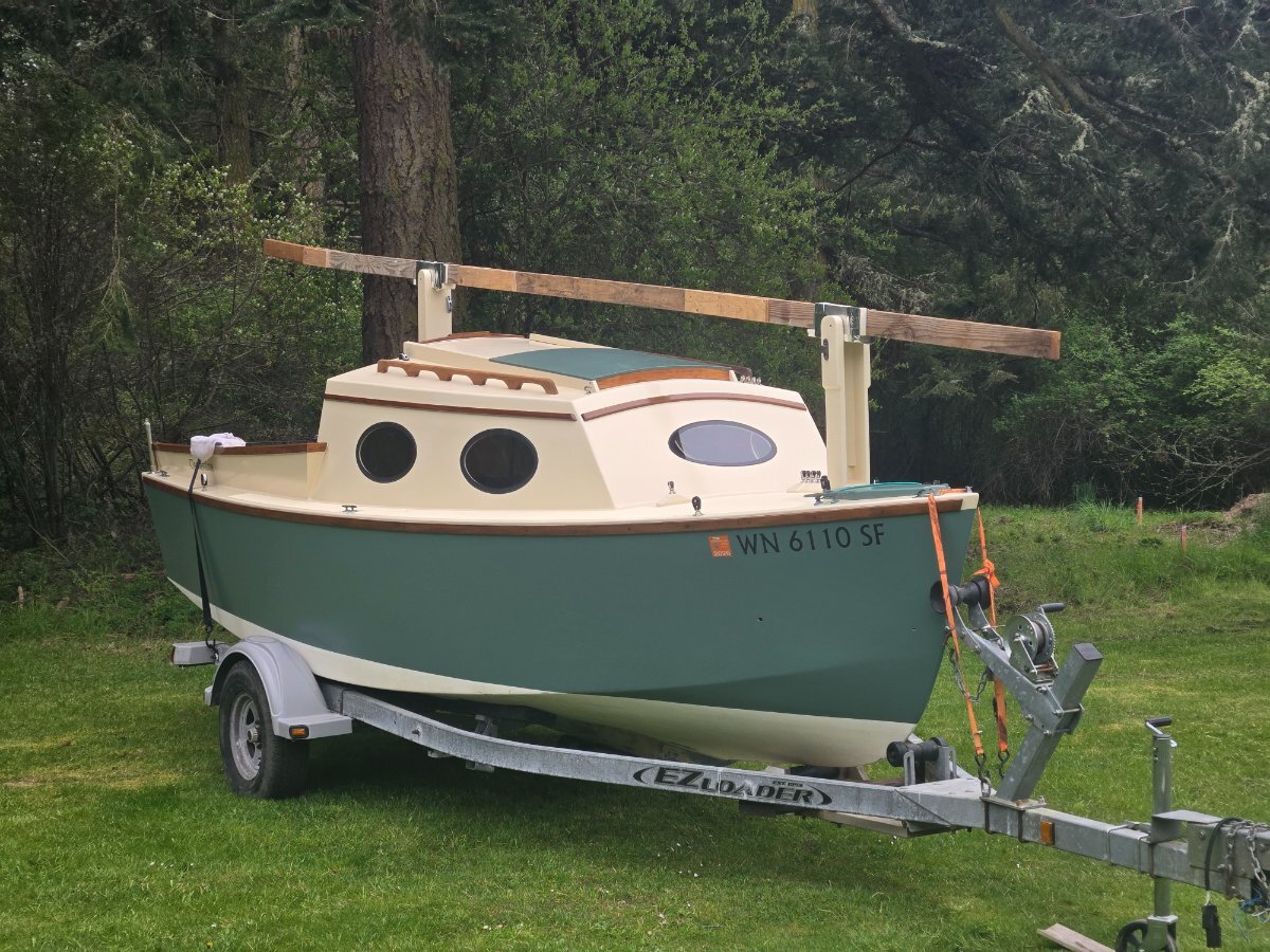

  8. Wow. What a surprise. I am alive and well, retired and hiding out near Port Townsend Washington with the Belhaven 19 and Coresound 17. I believe my B19 trailer is a EZ loader model EZL80. EZ loader quit making sailboat trailers years ago. Best I could do was an adjustable bunk trailer. Local dealer was uncomfortable with the sailboat part, but connected me to their distributer who knew what to do. I just finish removing the disc brakes and surge brake actuator as they were badly corroded. Trailer brakes not required in Washington State until you get to 3,000 pound total weight. I'd avoid trailer brakes if not required. One other thing, I'm using the bunks to hold the boat up, but support the keel on an intermediate wooded support. I tried rollers under the keel but they always flatten under the weight. I float the boat on/off the trailer. Check your direct messages for my trailer VIN which may help identifying the exact model. Please post about your build and share some photos.
