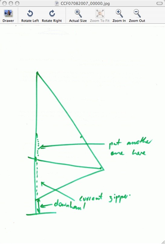

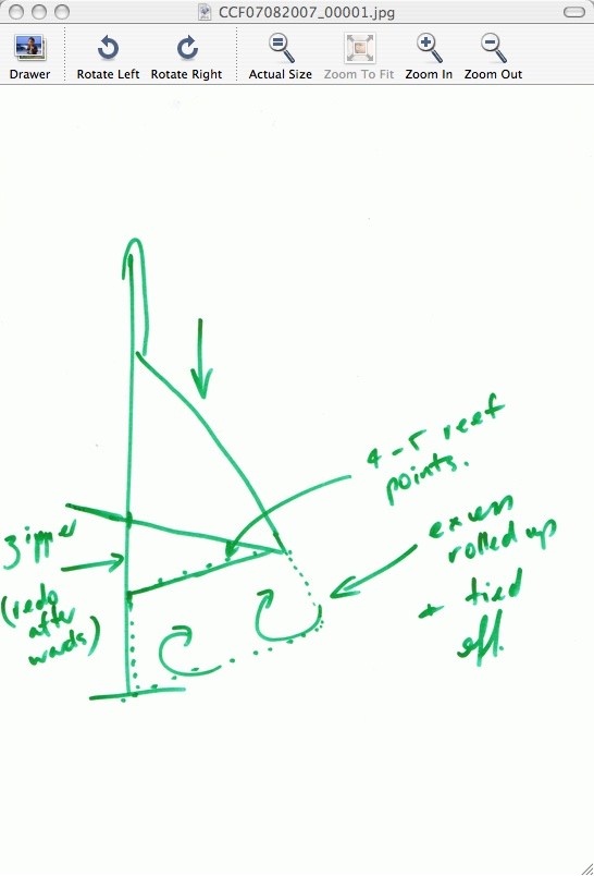

  1. Tell me if you think this will work... I have a zipper in the bottom of the luff pocket from the foot of the sail ie the bottom up to the first hole cut in the luff pocket for the sprit to go across ie the gap that shows the mast. All I need to do is put another zipper in the next bit of the luff pocket up until the top reefed luff pocket hole.. Have a reefing line tied into the top outhaul position and down to sprit boom ie new saddle or something simple on the sprit. To reef whilst out on the water... 1. undo current zipper at bottom of sail ie up to the normal luff cut out 2. undo new zipper in the next bit of the luff pocket. 3. slacken halyard and let sail run down mast. (thus avoiding having to undo and redo the sprit snotter, you can leave it attached) 4. connect downhaul to new position and redo the new zipper that is now between the foot of the sail and the sprits new position. 5. haul on the reefing rope that is in the leach of the sail so that it ties off nice and tight on the sprit. 6. retension the halyard and adjust the sprit/snotter 7. rollup the excess sail at the bottom and tie off in the traditional way. Sounds like it should work and it leaves you with a luff pocket with no sail track... so you can still store your sails rolled up on the mast as you drive along and when you are at anchor.. Pick holes in it please gentlemen.. Otherwise I will have to put the track on and get the sails redone. Went for a shortish outing on Sunday with Alex the 14 yr old daughter, I stopped on a friends trailer sailer and had lunch and a couple of wines whilst daughter and other 2 kids headed off out of sight in boat.. Was nice. R
