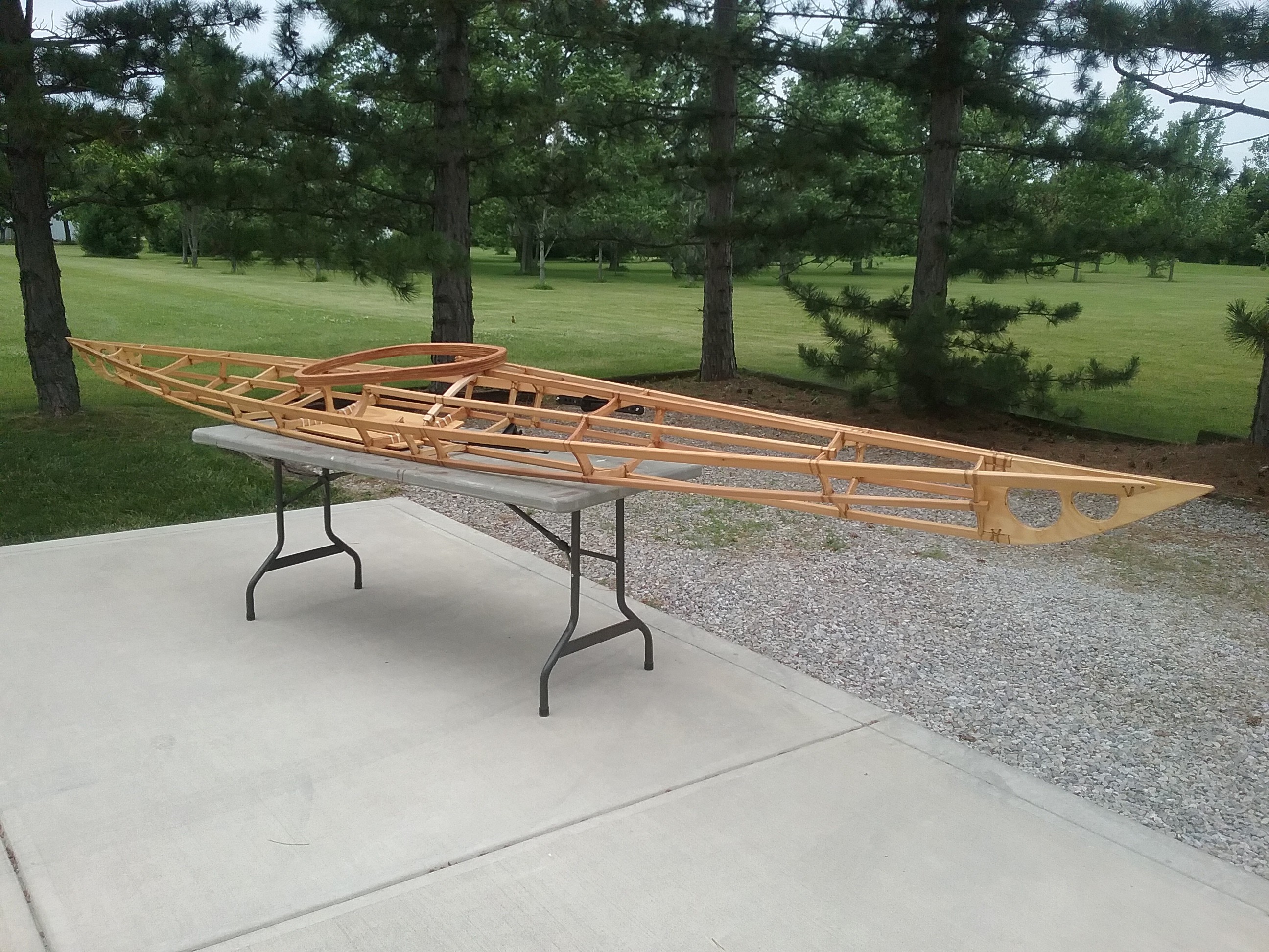

  4. Thank you. I'm looking forward to seeing the finished canoe. Thank you. The frame weighs just over 36 pounds.

  8. Thank you! The kayak is bright orange so the name Comet was selected after the orange Comet gold fish.
