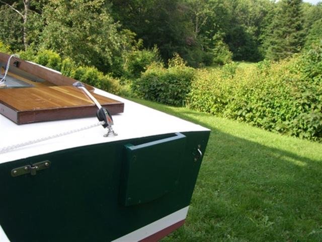

Here are the promised photos of my motor mount, designed to be as unobtrusive as possible, yet still funtional. And, it works beautifully. I use a MinnKota 30 lb thrust which pushes us along just fine, and absolutely quiet. I've only really used it once, 8 miles up a lake, out of wind, and had to be home. Rats, I'd have rather sat it out untill the 4 o'clock breeze!
