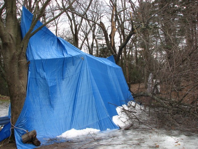

    Spared!
    It's a miracle! That limb was right over the boat - but somehow landed off to the side during a winter storm (wind in the opposite direction). It's always encouraging when your boat isn't smitten (smitted? spared), 'probably just waiting till I'm further along. Tom Z
