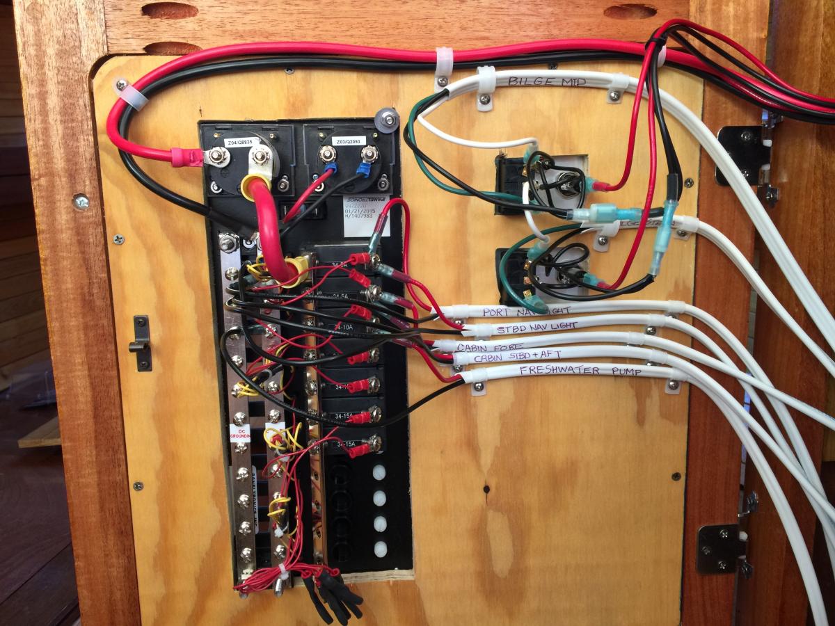

Yep. Looks like the same set- up. The only connections I've made so far are the lines in, so it shouldn't be too bad. Just seems like a poor design feature. I'll be loading the panel with breakers in the extra positions to hopefully avoide taking it all apart too soon in the future. I should have done that on the bench before installing the panel. . .but I seem to learn most things after doing it wrong the first time. Routing the wires from the bottom is a good idea. Thanks Tom.

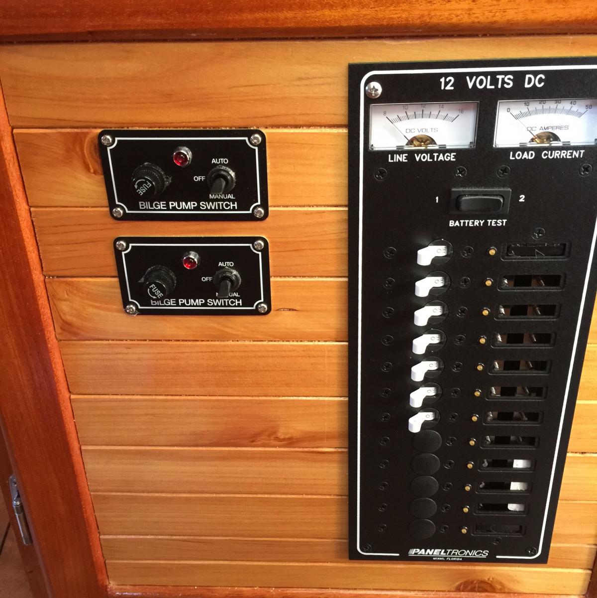

Embarrassed to have to ask, but . . . I want to replace a 10 amp breaker with a 15 on my AC panel. Should be simple, two screws on the front of the breaker and one on the back connecting it to the bus bar. Seems I have to remove the bus bar to get the breaker out, removing the screws from the other breakers on the bus bar. Is that right?
Thanks Tom. I think you're right - I may have been over thinking and confusing myself. All the devices I'm installing specify the proper fuse protection. All the lights are LED's and nothing pulls over 8 amps. I'm using a circuit breaker panel along with regular fuses. 8 gauge wire runs from the batteries to the helm. 16 gauge wire should work for everything except the wash down pump, which is rated 8 amps. I'll run 12 gauge wire for it. Still a lot more to wire, but I think it will work for me.
Thanks guys. I'll install a battery terminal fuse. Moving on to breaker size: is there a formula for determining the appropriate breaker size? For example, the chartplotter is rated at 1.2 amps at 13volts. It will be wired with 16 gauge wire, total length less than 4 feet. The installation manual states to connect with a 3 amp fuse. What size breaker should be used at the DC panel? A West Marine article says: Selecting the correct breaker size is a real problem for most custom and standard panels on the market. The issue is the impossibility of anticipating what breakers will be needed on a distribution panel, since all boats are different. Blue Sea Systems solves this problem simply. They reason that the majority of circuits onboard will have loads of less than 15A (certainly that is the case with most electronics, lights, pumps, small refrigerators, etc.). They also reason that most wire used for circuits will be at least 14-gauge, although it may be as small as 16-gauge. Therefore, they supply their panels with 15A circuit breakers throughout the panel, for the following reasons: If the circuit uses 16-gauge (small) wire, which has an ampacity of 25A, the breaker will protect it. 15A is larger than most loads on a boat. A small fuse can be used at the load, or a smaller breaker substituted in the panel if smaller current protection is necessary. So am I safe using a 10 or 15 amp breaker along with a smaller fuse at the load?
Thanks. I understand determining wire size from a device to the distribution panel, but I'm not sure how to determine the amps and wire size from the batteries to the distribution panel at the helm. Do I add the amps from every device connected to the panel? Seems this would be an exaggerated number as all the devices will never be powered on at the same time. Or, should wire size be determined by the total amps of the maximum number of devices that might be powered at the same time? The installer used 8 gauge wire to the helm with no breaker. Chuck
Your post wasn't a thread killer; this just seems to be a long project for me. I appreciate your help. Ended up with Paneltronics panels for the AC and DC systems. Still working on the wiring. When the motor was installed I asked the installer to run power to the helm. I understand I need a fuse on this line, close to the battery. Could I use a battery terminal fuse to meet this requirement? How do I determine the the amp rating for the fuse?
Moving into the wiring stage of the construction. Batteries are mounted, charger mounted, and power run to the helm. I'm thinking of using a prewired DC panel with switches and circuit breakers. Blue Sea Systems has a 13-position panel. Any issues with using this kind of panel, as opposed to a separate fuse or breaker block and switches?
